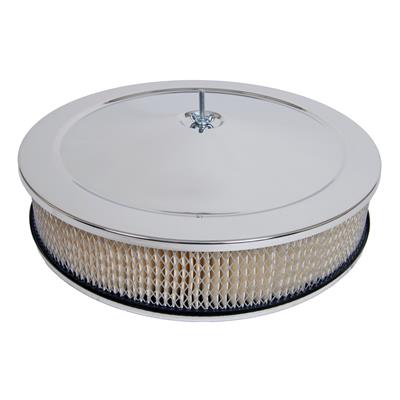

It is, however, getting a nice healthy big block and I'm thinking that maybe I should change the factory air cleaner housing over to one of those blingy open-style ones...
Something in that vein, though I'm not usually a big fan of chrome.
Anyway, does the factory one limit airflow at all, such that this style actually lets in more air, or is it just to impress the ladies?
-- A
I don't know about limiting airflow, but the stock will pull cooler air from the front suction point. That type of air filter will pull the hot air from the engine compartment. Not the best way to allow a BBC to breathe.

That would be my opinion is to have something other than the open cleaner. The open cleaner is bling, but that's about the only benefit it offers.
Run the newer type or go with a 5.5" air cleaner in the stock breather. You will have to change the carb stud but it's a cheap alternative.
