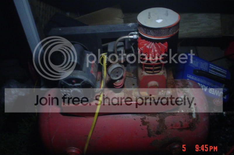

FWIW, I have a dayton 30gal that was given to me 10yrs ago, and it was at least 10yrs old then. Aside from draining it occasionally, it has never failed once. Even though it cycles somewhat often (every 10-15mins or so with heavy impact use) it is fairly quiet and 100% reliable.
If I ever found another one for sale, I would pick it up in a second.
