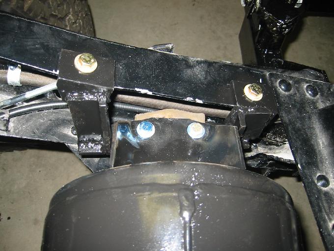

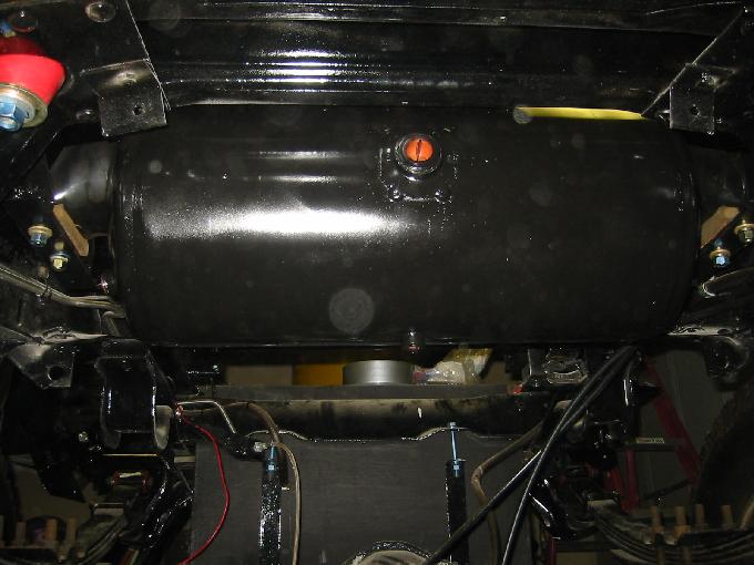

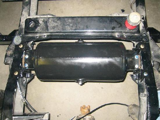

Here's some pics of my air tank installation. The tank is an OTR Kenworth air brake system tank, electrocoated inside and out, then expoxy coated inside.
Way better then those chepo ones you see around like on eBay. My favorite is the guy on eBay who constantly advertises air tanks for air-ride suspensions and says "This tank is rated to 150psi, but we've test it with much more pressure than that!"
I fit it up right behind the middle crossmember, probably not an option for you 77-up guys who have the rear fllor footwell. It fits nice and high out of the way of exhaust
looking good man, what is that for? on board air resivour?
Yep on board air, for tools, air up tires, and my air locker (soon to be lockers once the 14bff arb finally comes out).
Sweet! Is that a junkyard score, or did you just buy it new?
I did get it off of eBay, the guy had listed the manufacturer and part number and I looked it up off thier website. $28 with shipping, a good deal. Here's a link to the auction and here's a link to the manufacturers web page.He had like 6 of them listed at the time, but I see he doesn't have any now. I was scouring the web and eBay for tanks for a couple of months, ebay was the worst because most of the tank sellers there are selling these super cheap ones. If found a couple of tanks other places on the web, but they wanted like $100 or more for them. This was a sweet deal, and it was perfect size and shape (alot of the tanks where either really fat & short or thin and super long, this was a perfect shape for our trucks, tucks nicely between the frame rails).
nice work! air tanks are rad i got one on my truck too i took out my auxillary fuel tank and mounted the air tank in the same place i got a slick lil gauge, air line coupler and scrader valve to filler up- rated to 200 psi its where the filler cap used to be niice and convienant...
