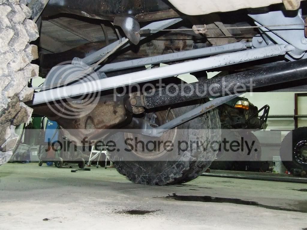

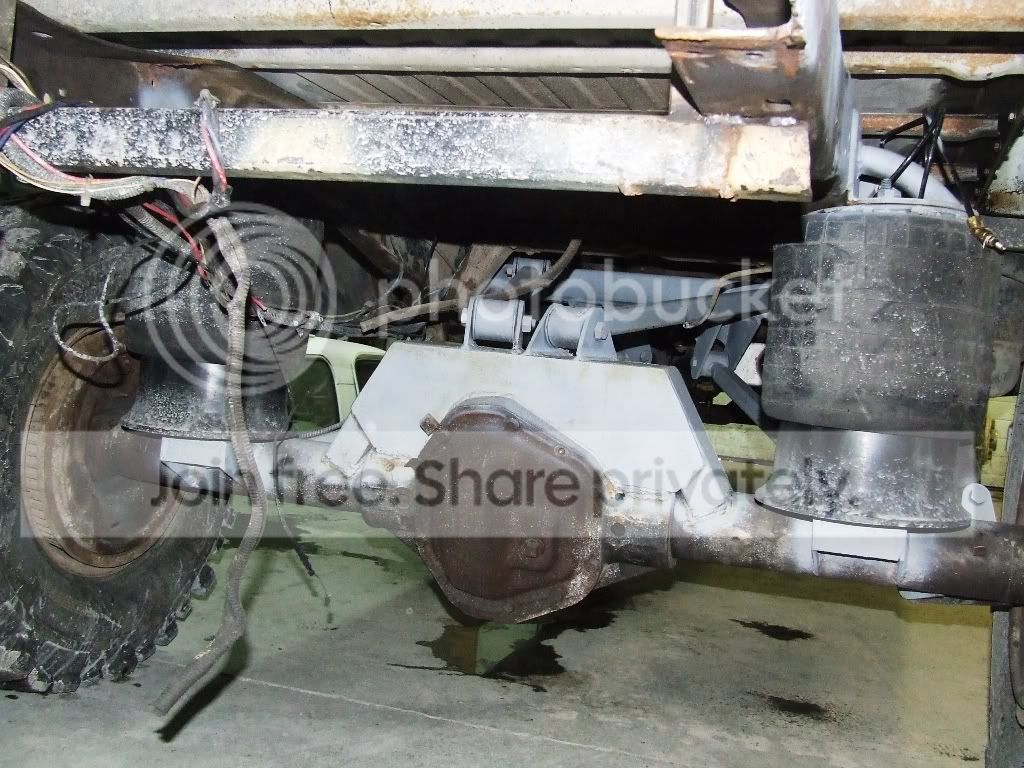

helped a freind of mine with this. 79 daully witha 4" lift he wanted to bag the back. got it done and bed back on, still need to figure out a swaybar and get new shocks for it couple of pics of the links and bags
Awesome .How well does it work?
so far so good its a bit soft, we will put a sway bar on it just not sure what kind yet. It rides really nice, also the shocks he has are pretty worn out the ltbs give a little wheel hop when you do burnouts too :D
Over all pretty good, plan on doing the same thing to the front but thats a year or so down the road
Wow. Those are big. I was expecting to see smaller diameter bags.
Are the air lines for the rear on the same circuit or are they seperate? if they are on the same circuit, going around corners will merely transfer air from one bag to another. This may be the "soft" feeling your getting if they are on the same circuit.
