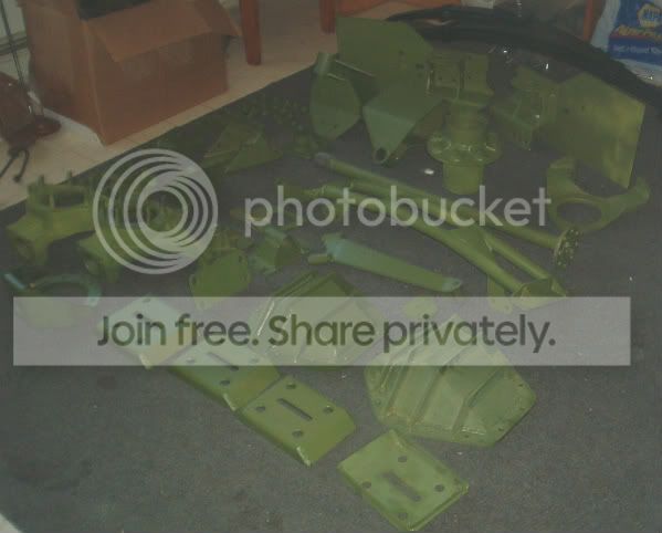

Ryoken, Glad you posted this. last week I went to the depont distributor in town looking for an automotive epoxy primer. He said he didnt have any and recommended the urethane primer you just posted about. Anyway, since I am working on the frame first I went to BLP and picked up some 2 part epoxy primer and epoxy paint.
Since then I have been wondering where to find an epoxy primer for automotive use. Thanks for clearing up my confusion.

It's been a little white now that I have sanblasted all my crossmembers and frame. I was looking at the frame and on the inside channel it looks a bit orange. Is that from not blasting enough or it rusting already? Still waiting for my primer to show up.
it's rusting.. doesn't take much time at all, weather, humidity, etc considered of course...
I had to reglassbead a few parts right before I primed, as they had been sitting around awhile...
it'll come right off with some 80-120, or rehit it real quick with the blaster... always best to prime the raw stuff ASAP...
