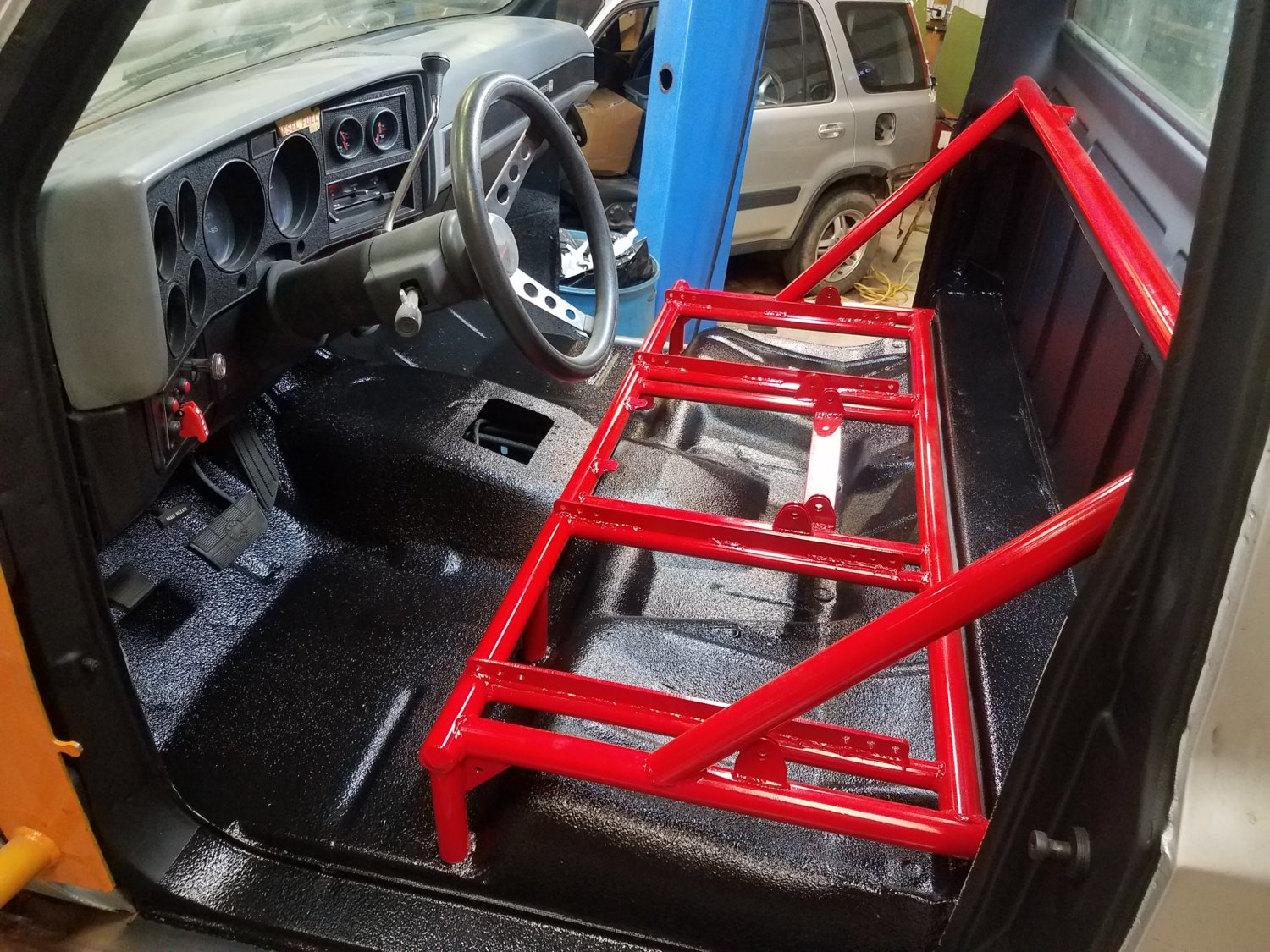

Took me almost a whole gallon to do a single cab interior. Very happy how it came out. I found the big gun a pain to maneuver around so think about where you want to spray first and how you will move the gun around in the tight spaces.

Mine took 2 gallons but I rolled it on thick, got pics in my build page, and I used Al's liner as well. Its held up pretty dang good.
