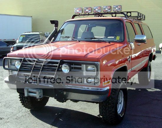

You mean some thing like the Dante's Peak Suburban?
Yes. that is one of a few threads that I have been trying to pull idea's from. I like the height on that one. the rear bumper from PMA build. think it was that one. been looking at so many
