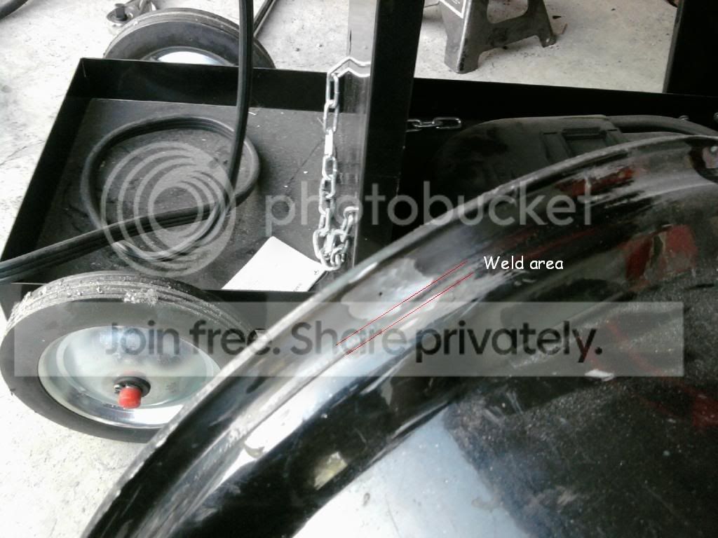

That was my original intention, but I can't tell where the leak might be on the inside. I'll see if I can find a pic.
This is what my wheel looks like except steel. No visible weld. Is the weld still where it would be on a set of DIY locks?

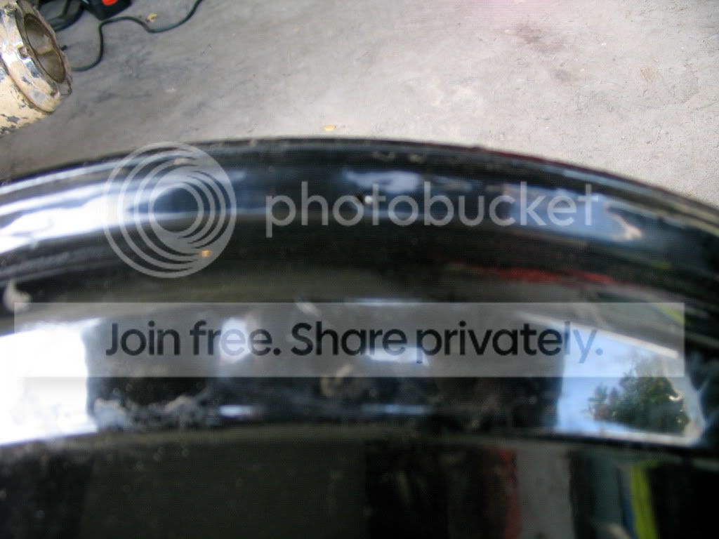

Well I finally got the inner bead broke on the tire and removed the wheel. As soon as I looked I saw the problem. There is a small hole in the weld.
Kinda ****ty pics.

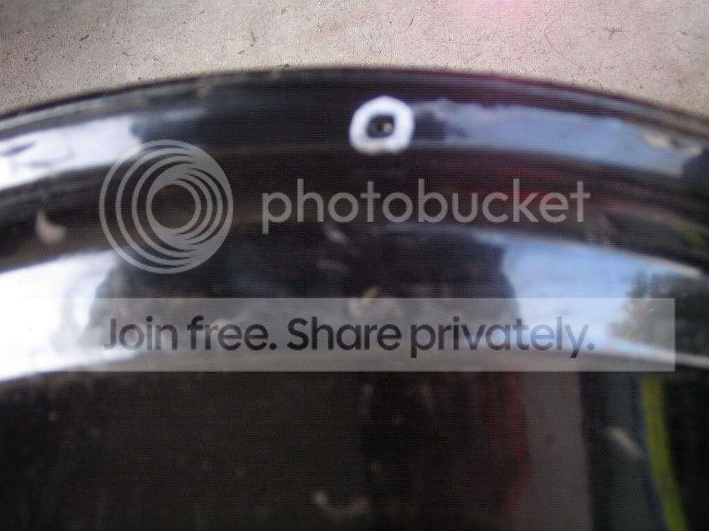

Circled the hole.

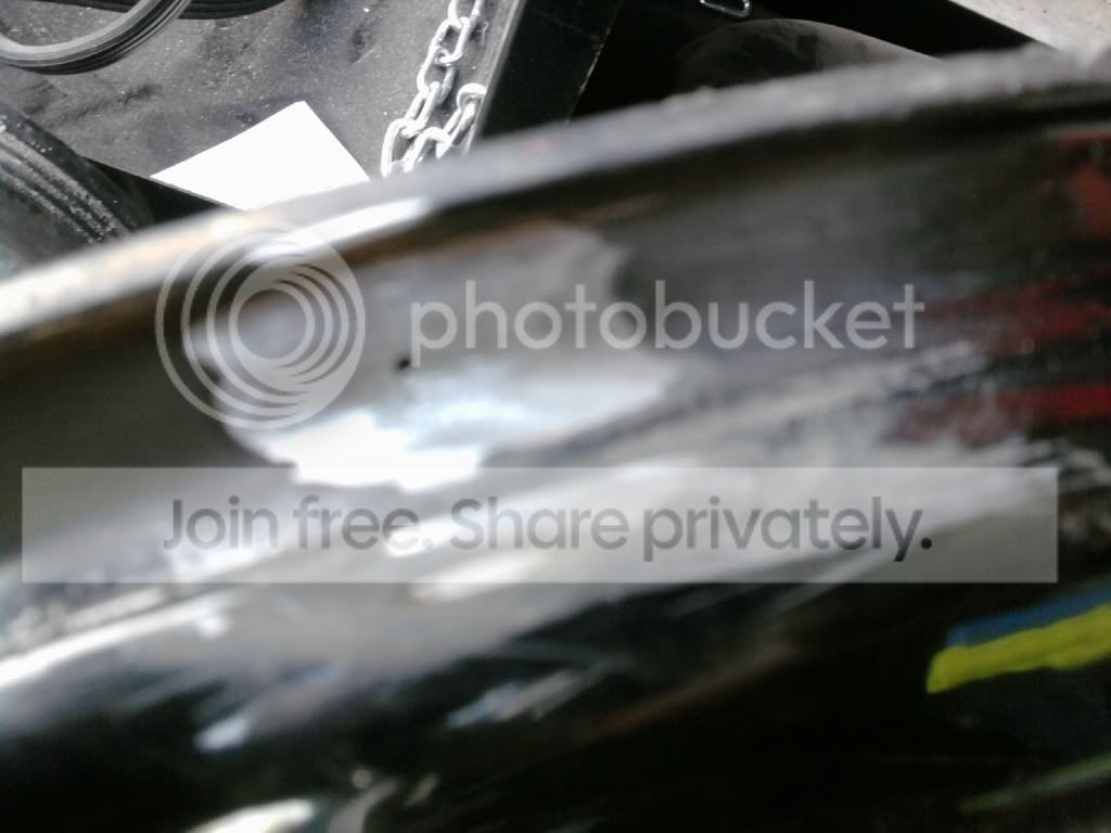

I dont have any pics of the weld, but here is after I cleaned it up last time.
Just nit picking... that doesn't look to be in a weld, it's in the base metal, from the pics. you have posted.

I'm pretty sure that is where the weld runs around the wheel. When you get up close its not smooth like stamped steel.

The area with the pin hole is also a weld. Its hard to see in the pic, but you can see the porosity where I ground the powdercoat away.
Yeah, that outer section is prolly formed like aluminum gutters are with the last 'op' being to roll/form it to the correct radius. They have a huge coil of that and just cut it into sections for each rim. The area with the porosity pinhole is the butt joint. My guess is someone ran out of shield gas when welding that particular ring together and never fixed it at the factory.
Allied should replace that ring at the least IMO. Barring that, the porosity definitely needs to be removed as best as possible before trying to weld over it or it'll keep coming back.
