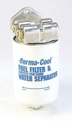

Funny you ask about the tank sitting in diect sunlight. I've had 2 cells, my first was a 12 gal plastic cell (w/out guage) that was uncovered in the bed of the truck. This cell would sweat horribly, it would create about a quart of water over a month. My second cell was an RCI aluminum 22 gal unit (w/ guage). I was so fed up with the water problem that when I got the second cell I also bought a tonneau cover and a water seperator fuel filter. With this set up I no longer had any condensation problems.
Was the water collecting in the tank? Was it causing you problems? I'm looking at buying a 32 or 22 gal summit plastic cell w/out sender for right now, should I get a water separator fuel filter (never heard of one of those, is it like whats on an air compressor?)
The water was collecting in the tank and causing some drivability problems. Since water is heavier than gas the pump was picking up the water and filling the carb with it, later on I also had problems with the electric fuel pump because of rust build up on the pump vanes..
Here is the water seperator filter that I used, it is about the size of an oil filter and it has a drain on the bottom to relieve any water collected.
Summit part #PRM-81794
No electric pump required. I used one because I was racing the truck in mud bogs at the time and had a very hungry motor. /forums/images/graemlins/wink.gif
