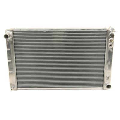

Any pros or cons to the following manufacturers that you know of?
Summit 380482: seems like a real close to my stock 77K5 radiator, so it should be direct replacement. 1" tubes, Price 289+

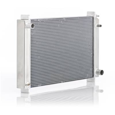

BeCool 10013 slightly different dimensions but says it fits. Also no trans cooler (not a big deal for me), 1" tubes, 299+
Why is their 60013 series so much more?
