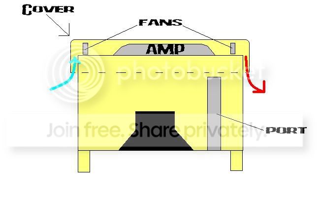

    [​IMG]
    Something like this would be practical. Put the amp on top of the enclosure and make a cover for it like the lid of a gift box. Build the cover to have maybe .75-1" of air space between it's lip and the sides of the box. Have a push/pull setup of fans underneath the box to introduce some sort of cross ventilation to cool the amp. This keeps the amp out of the elements, cooler than inside the box and still tuneable if you make the cover removeable.
  18. bp71k5
    bp71k5 3/4 ton status Premium Member
    Joined:
    Mar 31, 2006
    Posts:
    6,257
    Likes Received:
    294
    Location:
    San Jose, California
    nice idea.:bow:
