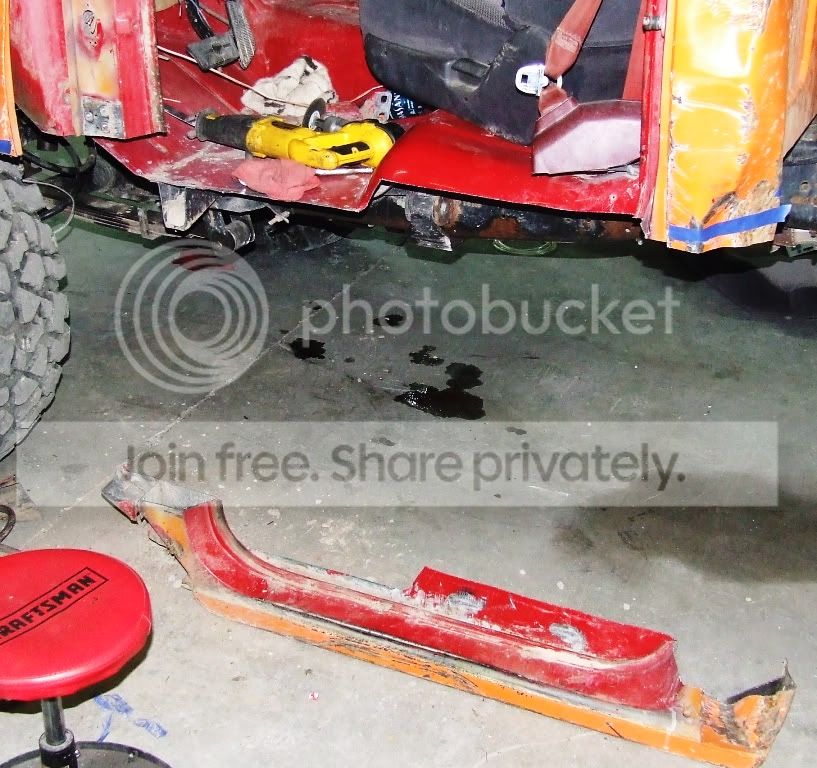

So got part of the boatside on one side done today. I want to actually make the whole floor..........well a whole floor no big holes in it or anything.
Here is the pics

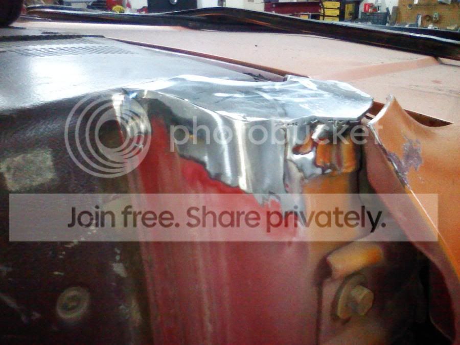

First cuts actually went higher up than this but not much, sawzall with a 8" blade did most of this cut
I also used a body saw and grinder and a die grinder to get everything cut out. Heres what I ended up with everything cut out
This is pretty much where the rec. tube will reside. Where I cut it if you were going to keep the cab you could actually put the doors back on pretty easily. I am going to try to cut everything off to make the edge of the body pretty much even with the outside edge of the tube.
I am also going to trim the firewall where the tires hit better. Before I just clearanced with a large hammer and it worked alright but this time I will actually cut out the metal and redo that particular part of the firewall basically where the footwell is

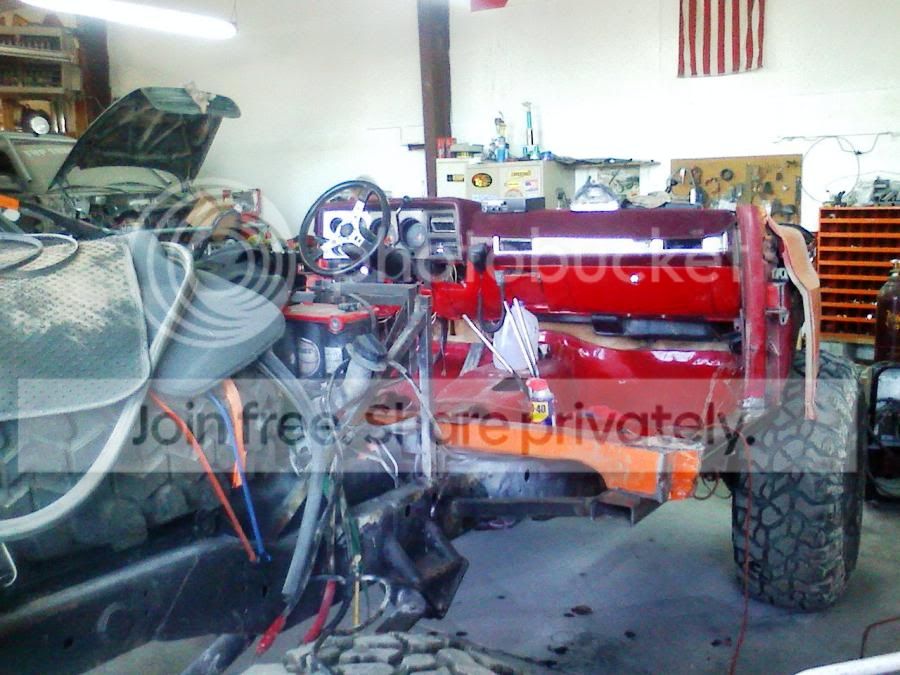

This shot shows how the rear of the cab (which won't really be there much longer) will get quite a bit narrower.

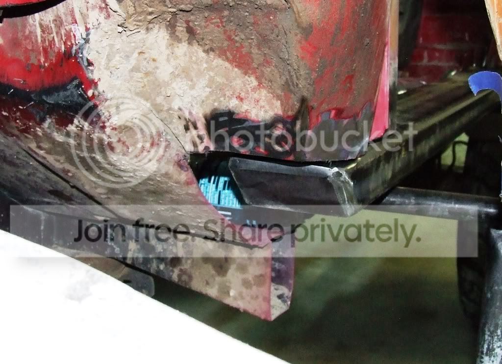

Here is how two of the braces look coming up through the floor
This pic shows the brace that would go directly under the seat, I didn't do this intentionally but it looks like this type of boatside would clear the stock bench seat

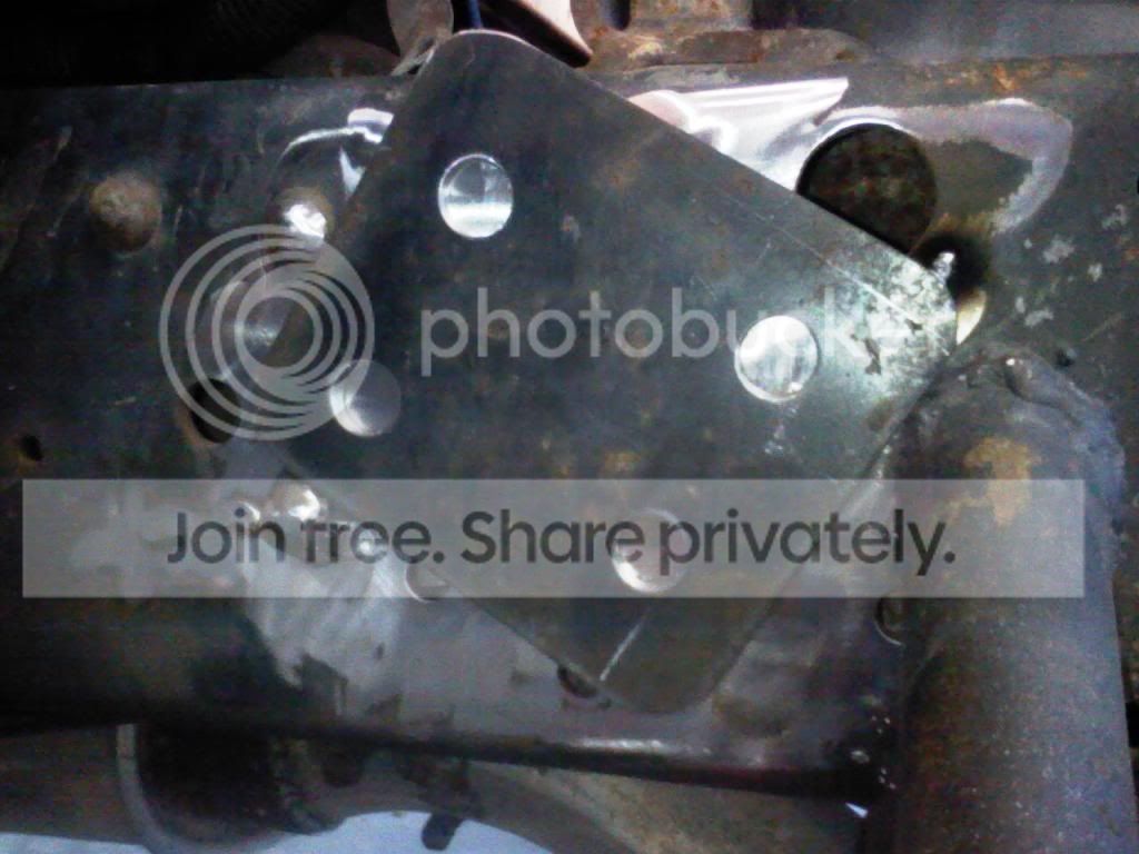

Just a couple pics of one fishplate I made to brace to the frame
The stupid Chevy frame is so full of holes its hard to miss all of them

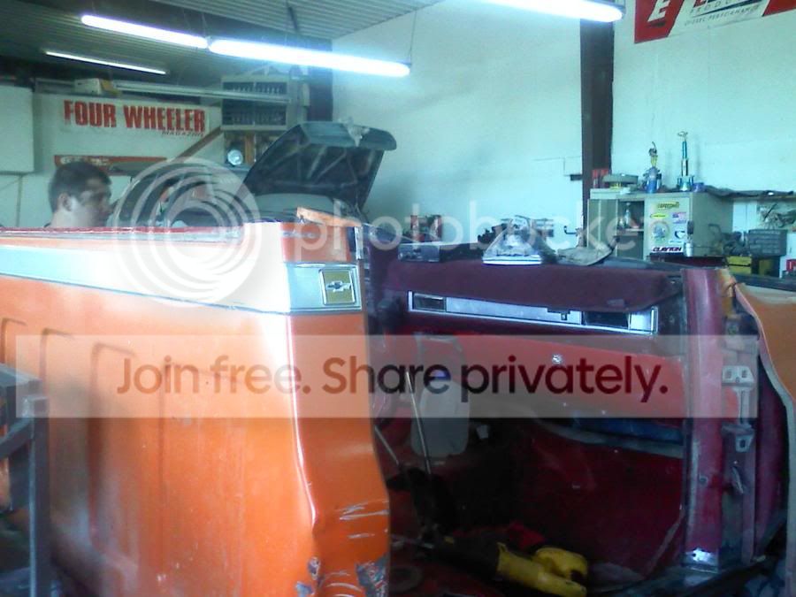

Got the boatsides done so off comes the cab
took the roof off first and the then the bulkhead

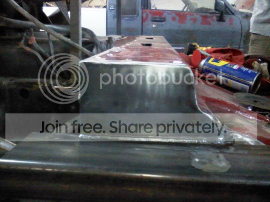

Started to cap off a couple of the ends that needed so.

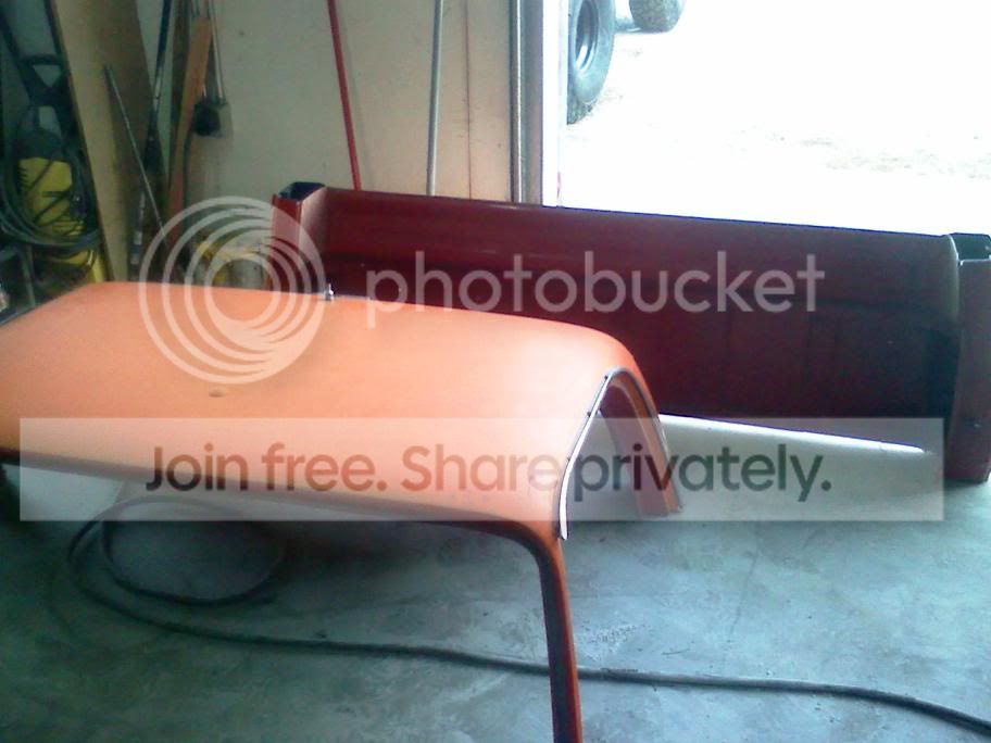

This is the windsheild pillar, need to take the fender off to finish this piece up
The side cap on the floor
