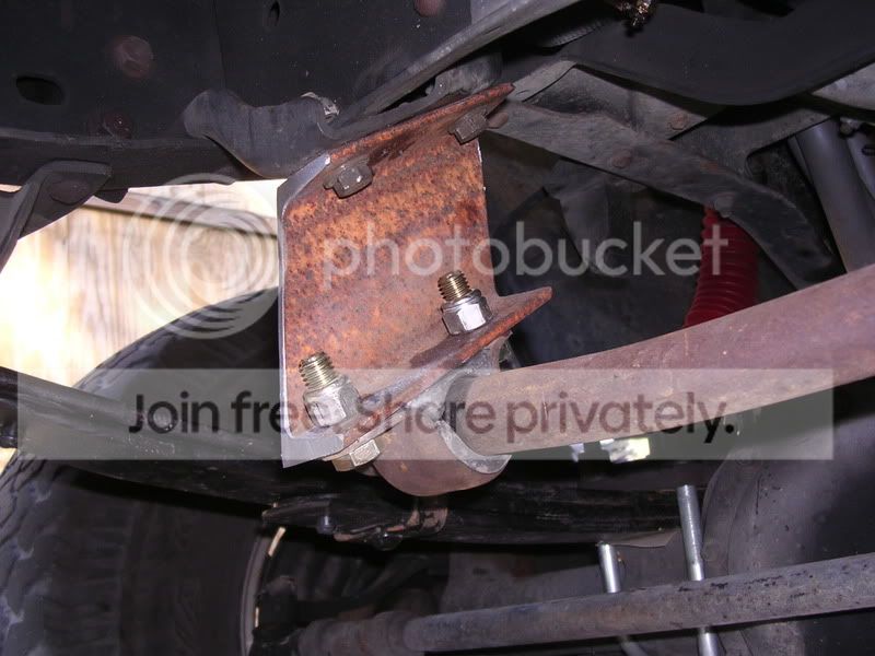

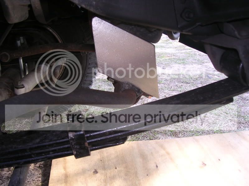

Well, I decided to make my own sway bar drop brackets this morning. I used 4" channel, and threw a ghetto paint job on them for now. I'll repaint them when I get my new bushings.
The truck drives MUCH better than it did with either the sway bar in the stock location or disconnected. Bump steer and wandering is pretty much gone. Now I wish I wouldn't have bought that pitman arm from Summit yesterday for $103.:rolleyes:

Its just a 4" lift, and I dropped the sway bar 4". It made a 100% improvment.

with the sway bar in the stock location, the angle of the bar keeps the axle from being able to move rearward when you hit a bump. My truck now has no bump steer and rides smoother(than it did with the SB in stock location).
With soft flexy springs, you NEED to correct the sway bar or add disconnects to it.

there are two things that control axle movement. the springs, and the sway bar because its a solid connection between the frame and the springs/axle. Now, by lifting the truck and keeping the sway bar in the stock location, it creates a situation where the springs and sway bar are moving at different angles when you hit a bump causing binding.
It amazes me how much softer the ride is now.
