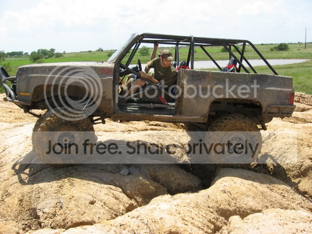

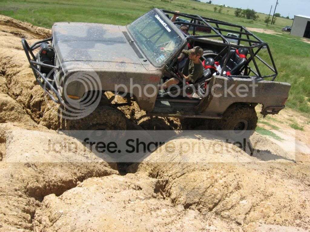

Mine is just resting there as of now but by the end of next week it should be all bolted down and tied to the frame in 4 places using some bushings from Kert. It will also go all the way to the back eventually will all sorts of triangulation. I will post some pictures when I am done but here is how it is now, 2" and 1.75" .12 wall HREW
