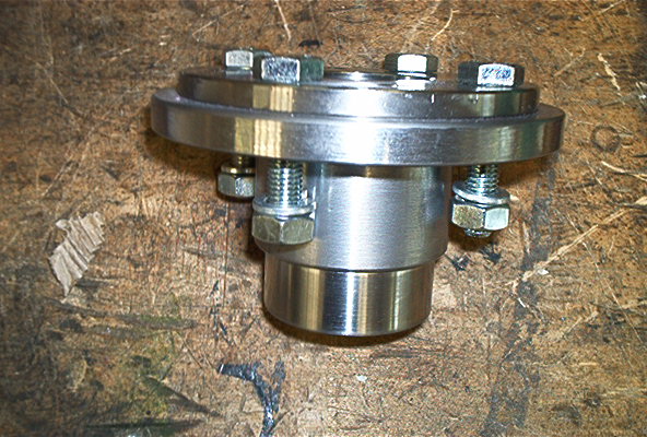

"Never heard of a flange yoke on a 14 bolt but I would probably keep it. The flange setup is superior to the strap/u-bolt business."
Do you know if there is an adaptor or something I can buy to put on my drive shaft to make it work with the flange?
From HAD website. under the Toyota section..
HERE'S THE 14 BOLT FLANGE CUSTOM MADE ITS EXPENSIVE AND HAS LEAD TIME - COST IS 289.00$​
Why don't you get the shafts from the donor truck and keep the flange. Everybody keeps sayings its a better set up, ane as mentioned above if you swap yokes you are supposed to re set up the crush sleeve and pinion preload. Shortening the donor driveshaft would be much easier.
The piece you need looks like this. You'll need to figure out which u-joint your driveshaft uses, who made that flange which pilot size and bolt pattern your flange has.
My guess is that high angle driveline made your flange and calling them will get you the info you need.
