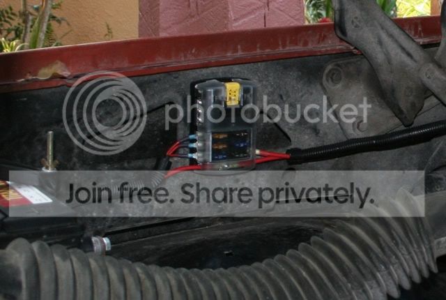

Now, since i'm replacing the harness, could i run auxilary lights and my backup electric fan (Florida heat) off of some of the empty spots in the fuse panel (if there are any)? Or am i better off leaving them wired to the BlueSea fuse panel that i have by the battery now?
This is what i currently use for my fan, 2 front aux lights, 1 rear aux light, under hood lamp and to substitute the fusible links.
I think you are best off the way you are...the fuse panel isn't designed to supply much power to anything, those accessory terminals on them are best used to switch relays with the ignition, that's about it.
