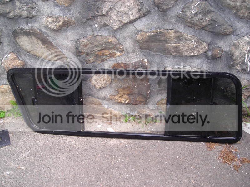

also picked up another 89 fullsize silverado blazer with a bad tranny and 80,000 on the motor. new aftermarket slider windows for the hard top, light bar, and 1500.00 worth of patch panels.

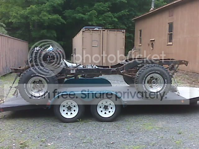

heres the only pics i have now on it

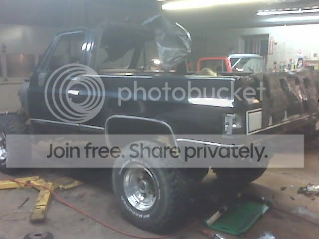

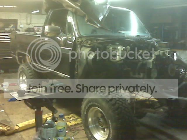

pulled the doors,fenders,hood,cowl,interior,and top.
belive it or not. all the body mount bolts came out with out a problem. the last 2 by the gate are rotted away.
so far i picked up a used tailgate that is alot better than mine. brand new black carpet, rough country rear shocks brand new. used light grey cloth seats for the front and rear. dash padand a push bar.
just picked up a chain fall so i hope to aim for tomorrow to swap the body over.

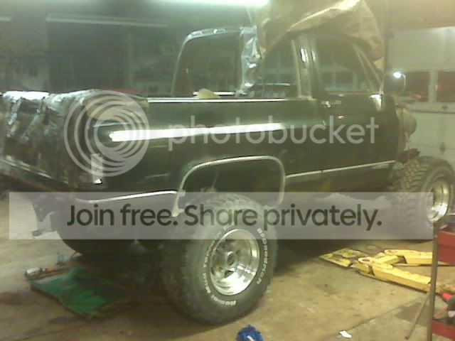

swaped the bodys today on th k5. tomorrow im gonna try to put the core support and inner wheels in.
didnt go to bad swappin.
the body in the pictures.i used a chain fall. i hooked it in the back where the rear seat clips into. then for the front i hooked it with a nut and bolt with a chain where the seat belt are on the floor.

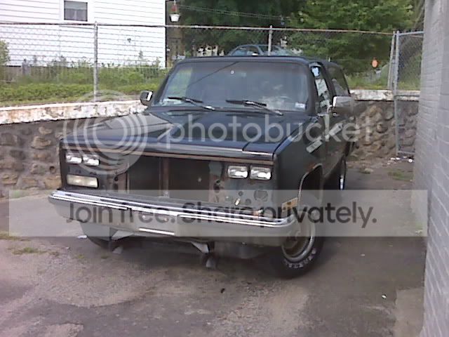

glad to help/ i have to post up a few newer pics. i slapped the fender on just so i could drive it. the new body needs a rocker small section of the floor, cheater quaters on the driver side and a small spot above the rear wheel.
