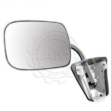

Hey, what about mounting the antennas right into the mirror casings? For mirrors like this:
Instead of using one of those clamp-on brackets with the bolts sticking out and coax hanging out - put the insulated stud right through the little stainless housing on the side of the door. Then the cable can be routed inside the mirror mount and you would never see it. Anybody ever analyze the amount of space in there?

The casing itself it pretty thin. If you mount it directly to the casing, I dont think it would work that good. The casing has a rubber seal hooked to the body. Mounted like I have, Its grounded to the body.
I think.
