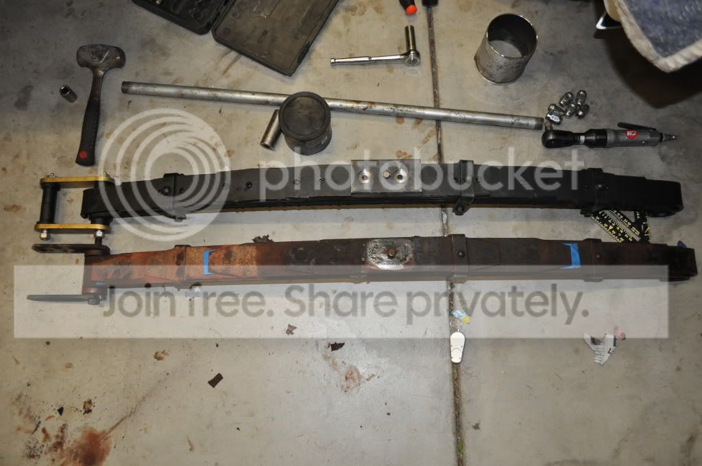

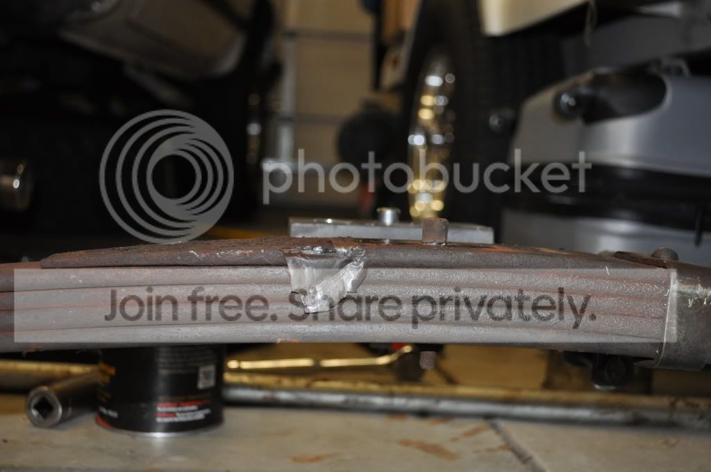

OK, got all the parts but wanted to double check something before installing. When I lay the two springs side by side on the concrete, one of them is about 1/4" lower than the other one.
Is this normal and will they pretty much even out after they have been installed? I just don't want a lopp-sided truck with brand new parts!
I got new 2.5" BDS springs, 1" zero rate leafs and new, greasable shackles from ORD. Should be good and stout now....but smooth riding!!
that might be kinda weird, the measurements being off and all, but they aren't precision pieces I guess. Just put the one that is taller on the drivers side.
Dunno about new springs, but I've found that the old packs I've been playing with (52"s and 56"s) sit a bit differently when unloaded vs when loaded, i.e. measure out just like yours but end up mostly even when loaded.
I suspect yours will settle into place. Worst case you might stick 'em on a piece of carpet or something to keep them eyes from getting all scratched up, then stand on the arch a few times to stretch 'em a coupla times, see if that evens the measurement out.

Just got word from BDS....sounds like it's OK and within specs.
"Ted says:
There is an acceptable range for the leaf springs for free height. Typically they equal out after install
Ted says:
Yes, it is normal to have some inconsistency in the leaf springs free height. The taller spring could go on the drivers side.
Ted says:
The springs are coated, and sometimes the coating makes the spring more stiff until the coating breaks up"

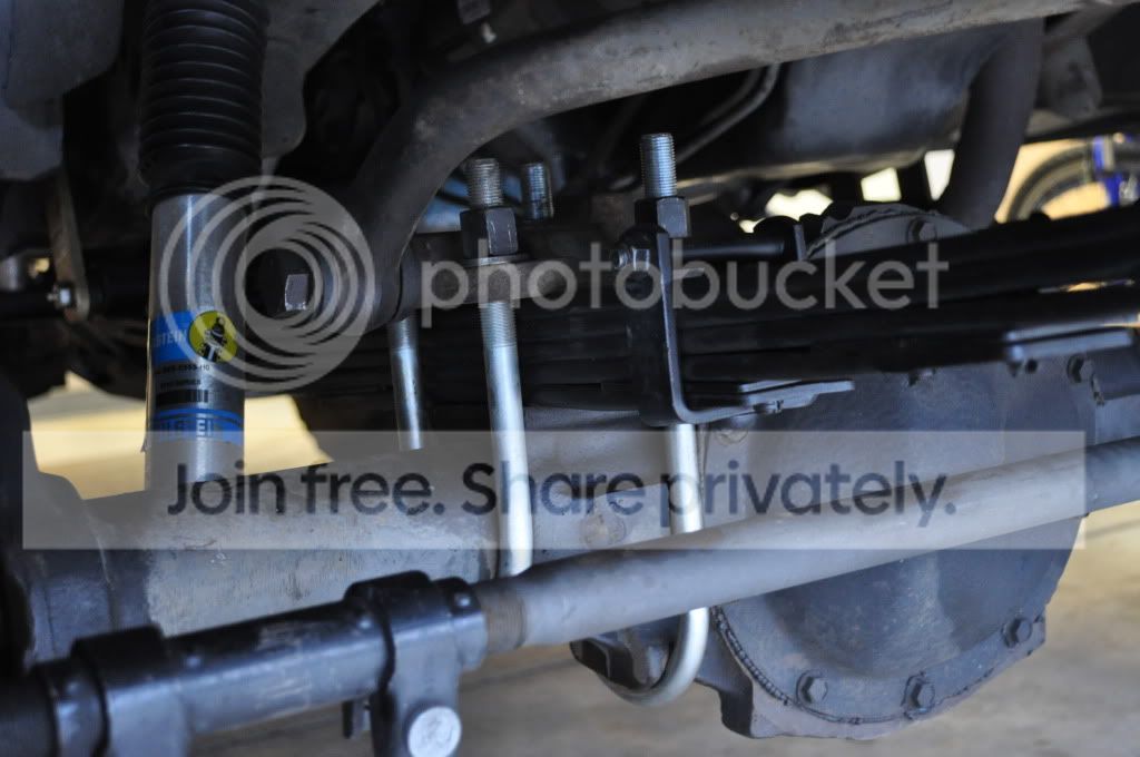

Well, I got it all installed over the weekend and really found out a surprise. All this time I've thought I had a 4" lift.....how could 35" tires fit with anything shorter?!?:confused:
Apparently, I probably had a 2.5" lift instead or it has really sagged a lot in both the front and back!!

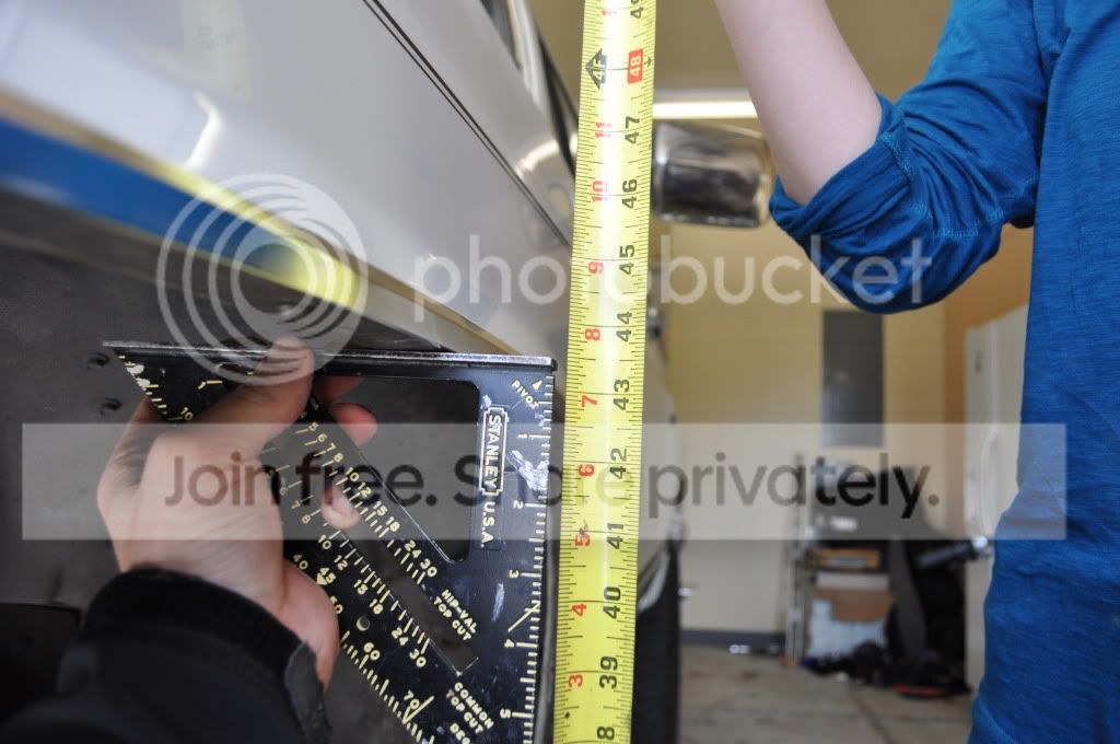

Anyways, I started off with the 2.5" springs and the 1" zero rate. After looking at it (and measuring), I was indeed higher now than before the spring replacement.
I do know they will settle a little bit but how much, I don't know. So, after seeing it with the zero rate, I decided to remove it and just run with the springs by themselves.
Overall, it looks much better.

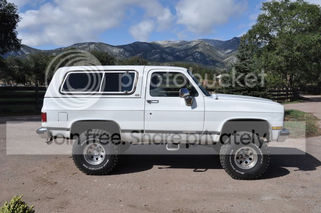

And, after a few days of driving, the ride is definitely improved! More control and also a smoother ride. Very happy with the final product!

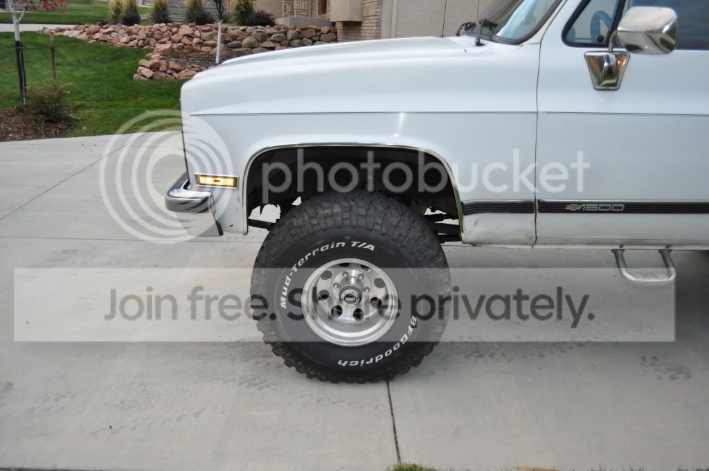

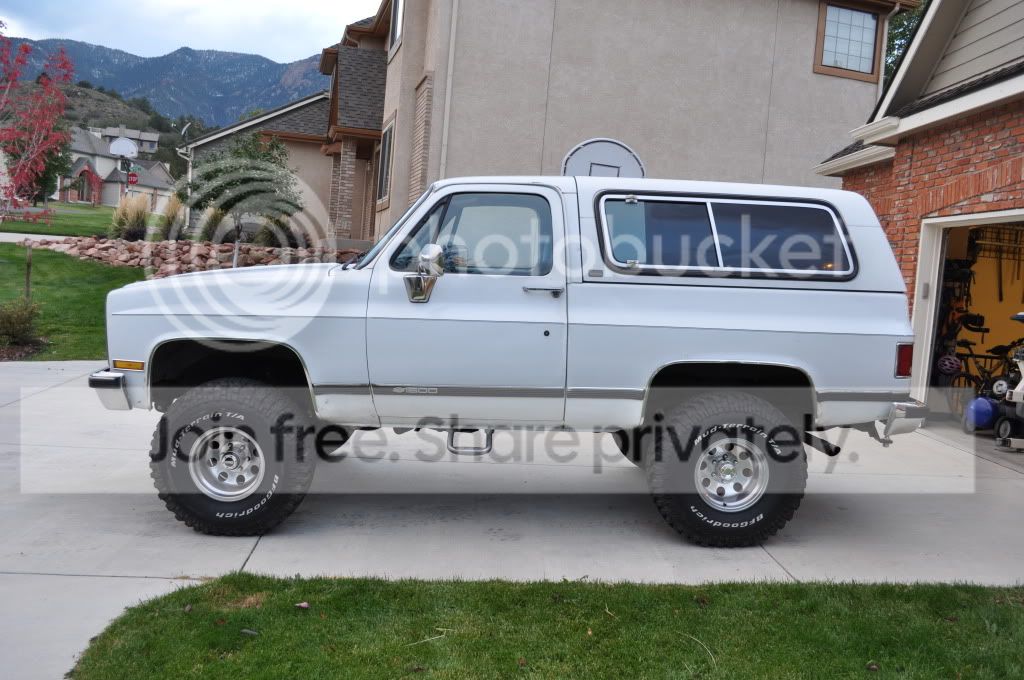

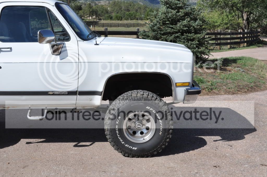

Original measurement before any of the spring work......

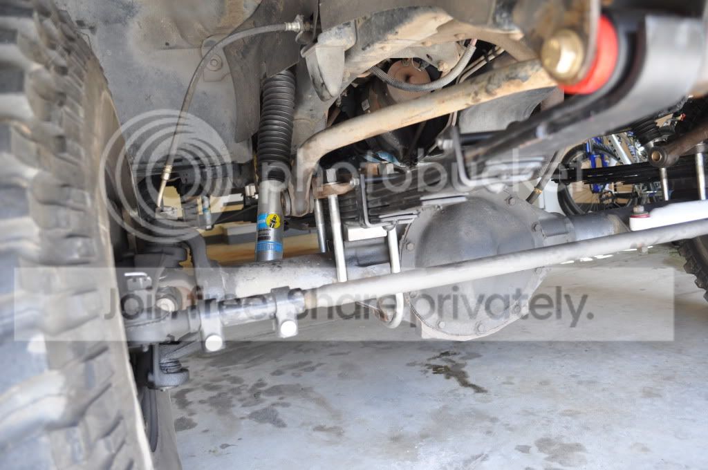

Here are some sequence pics with the zero rate and an overall lift in front of 3.5".
After a few days of driving....it looks to be settling in well (visually speaking). How much should I expect the springs to settle??
You will probably need to put the zero rates back on. You might end up rubbing on your fenderwells in the front when your turning into parking lots or driveways. I have seen the fenderwell corners gets smashed even with 4" lifts and 35s
