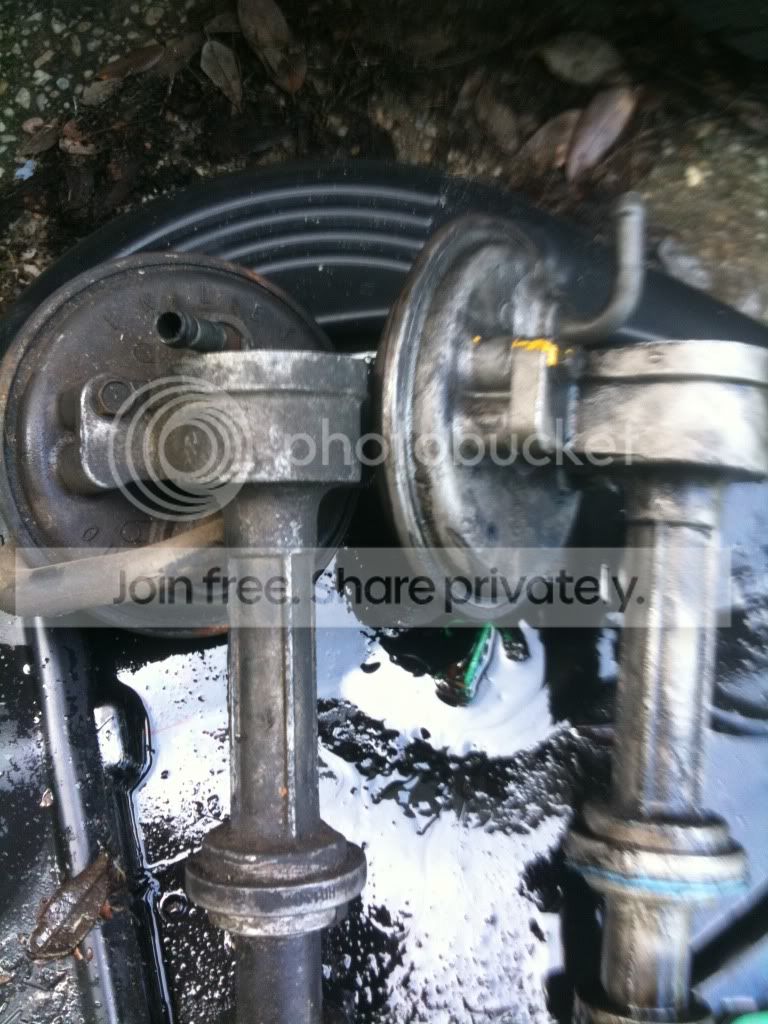

R Rob 85K5 1/2 ton status GMOTM Winner Joined Feb 17, 2000 Posts 1,487 Reaction score 0 Location Pensacola, Florida Oct 10, 2009 #1 The pump on the J code is leaking, the pumps look different, but will there be a difference in function?? 85 C code left - 88 J code right
kennyw @squarebody.chop.shop on IG Premium GMOTM Winner Joined Jun 9, 2002 Posts 18,853 Reaction score 12,454 Location Stevens Pass Highway, WA Oct 10, 2009 #2 It looks like there is an extra fitting on the C code pump, just cap it off and you should be fine.
R Rob 85K5 1/2 ton status GMOTM Winner Joined Feb 17, 2000 Posts 1,487 Reaction score 0 Location Pensacola, Florida Oct 11, 2009 #3 I went ahead and used it, no problems. That "fitting" is a hose that runs from front to back.
