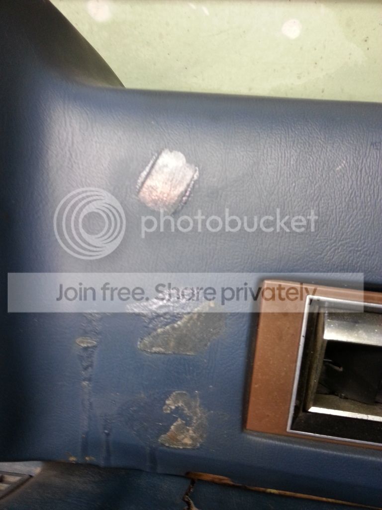

Any ideas how to get this adhesive off my dash?

Looks like someone glued velcro strips onto it at some point. I tried brake clean and wd40 and they didnt work.
Brake Cleaner? Are you trying to wreck the dash?
If it's standard tape or sticker adhesive, the proper tool is Goo Gone, Goof Off, Sticker Shock or similar. If it's an expoxy of some kind, I have no idea other than to carefully pry it off?
I tested it on my bad dash first. Its like super glue. How it becomes plasticy and brittle when it dries,but sticks like a mofo! I'll pick up some of the goof off stuff and see how that does.

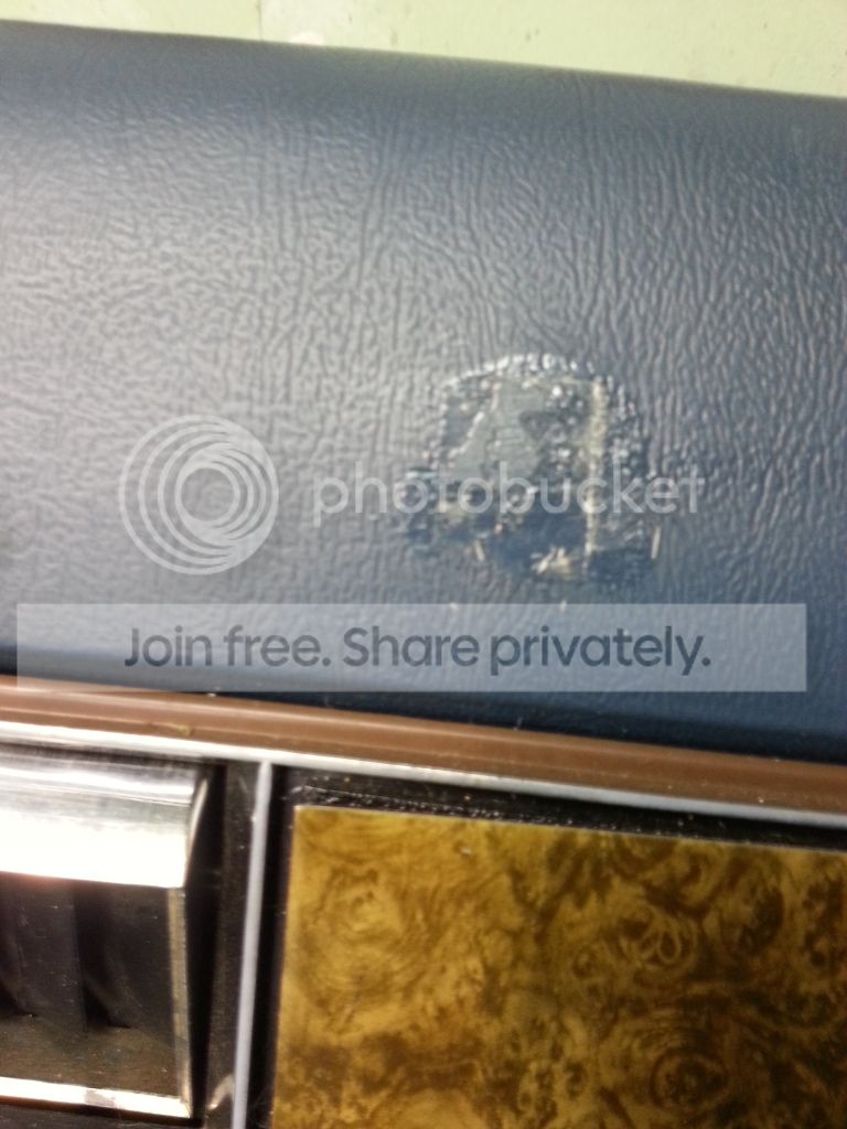

I have used fingernail polish remover as well. I used it to take the side molding glue off my buddy's moms car when I replaced the fender for her. Works real good and didn't hurt the paint at all. Goo gone works decent too. That took the crap off the window after I removed tint on my new blazer. Harder chunks like yours you may have to attempt to gently grind it first with something. Looks kind of like epoxy. Good luck.
