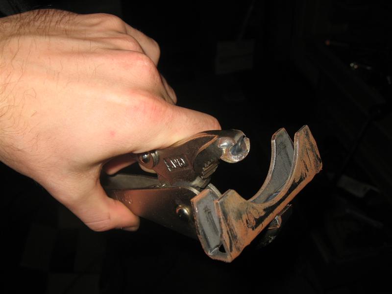

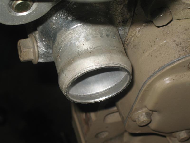

Check out post 130
http://www.pirate4x4.com/forum/shop-tools/482425-show-your-hand-made-tools-6.html#post10304688
