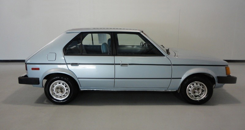

I've mentioned it before in here.. THE absolute WORST color ever was Chrysler Ice Blue from the 80's...
total nightmare to match 1/2 the time...
I disagree. Hyundi has a color that came out 3 years ago. It is also an ice blue. Has an additive that runs $170 an ounce. It looks like a mica. I never did match it.
