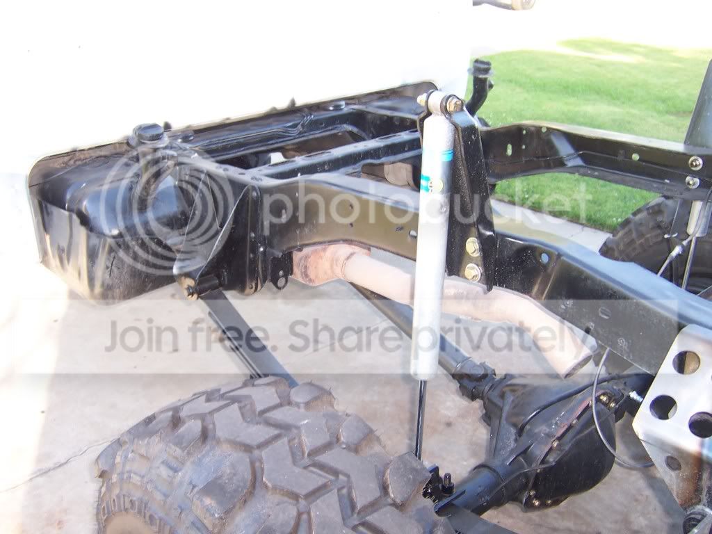

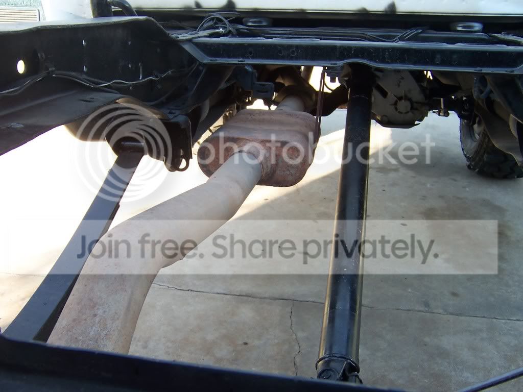

I can't imagine what it would hurt but figured I should check... basically I want to cut it about 4-6" behind the muffler...
These are some old pics but you get the idea...

I'm planning on having my exhaust completely re-worked eventually and going to a stainless setup to help keep the pismo rust away but for the time being I was thinking of trimming it up. When we're bouncing through the dunes I've looked back before and it's shaking all over the place because I cut the furthest mount off when I did my rear suspension (it was a part of the old bump stop bracket). There are two straps directly on the muffler so I think if I cut all the extra pipe off the back it might stay in place a little better.
