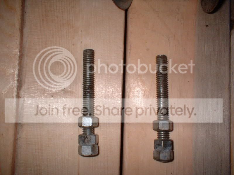

I've found it easy to use some alignment dowels (threaded rod) to guide the transmission into place. Thread one rod into each lower hole. Then you can get the transmission started on one of the rods and start a nut on the rod to hold the transmission in place. Then you can adjust the transmission to start the other rod without the first one falling off. You can tighten the nuts on these two rods to bring the transmssion up to the block. Then install the 4 upper bolts. Remove the two rods in the lower holes and replace with bolts. Be sure the transmssion is square with the engine as you tighten it up to prevent the case from cracking (I'm not sure it would ever happen, but be careful just in case).
Here are the two rods. Install them with no nuts. Put the transmission on and tighten it up with one nut on each rod. The double nuts were used to remove the rods.
