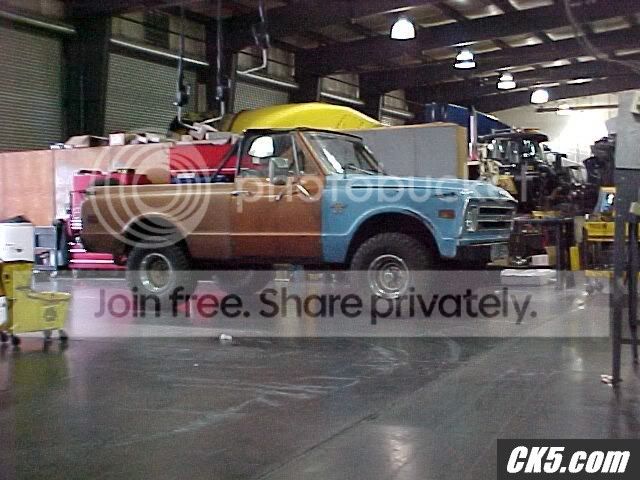

If so put up some pics. The weather is too nice to keep the top on my '74 Jimmy. I have heard a few people are running with the CJ5 bikini top and would like to do the same. Does anybody have any pictures, mostly of how you have it mounted in the windshield frame. Show 'em if you got 'em.
Not the best pic
For the front I just cut a thin strip of aluminum and drilled holes to match the ones in the windshield frame. Then folded the front of top over the strip. I then used 5/16" bolts and fender washers to hold it down. The rear I just tied to the roll bar.
Perfect!! I had actually spoke with him a couple of times when he put that top on Craigslist. He is the reason that I got the idea I was just unsure how he did the window frame snaps, and those pics cleared it up. I should have known that he would have been a CK5'er
w/ snaps on windshield frame like that...will hardtop go on w/o messin up the seal..or snaps have to come out to put top back on?
