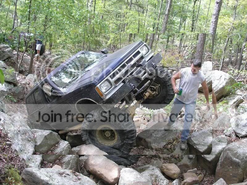

yeah its been done a bunch of times. i got a 93 running k5 blazer 10 bolts and beat the heck out of it, got a welded rear with some 33s and it just survived its 8th all day long offroad adventure
but to be technical mine was a 4x4 to start with but is basically the same idea. i threw out all the IFS crap
its pretty easy if you know how to weld and have alot of junk laying around.

mine was a 2whl low rider when I bought it, it had 3 inch lowering kit on it and was very low to the ground.

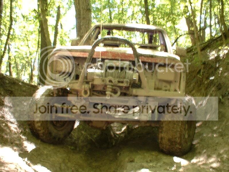

now with 39.5 and narrowed one tons , TONS of fun
Looks like it will be a piece of cake to do it.
mine was pretty easy cause i just made it ugly strong and functional. part that took the longest was setting up the rear hangers for the front leaf springs, rest of the time was just spent tracking down parts and putting them on
