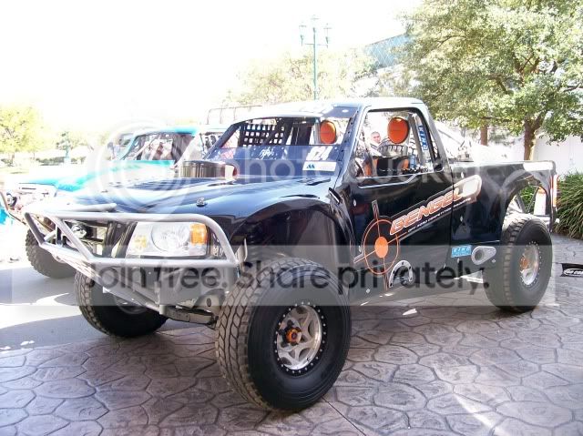

this basically what I am looking to build...flat and simple ....
Is it hinged or how does it attach ?
It has about a dozen Dzus tabs holding it on. You can see the little dots in the picture thats them. No hindges. :waytogo: If its going to stay on you can even use nutserts with 1/4 20 bolts or button heads.
