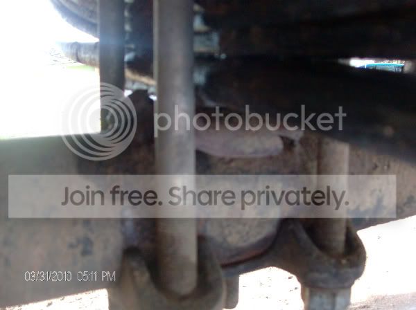

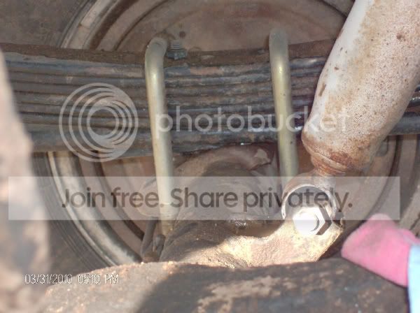

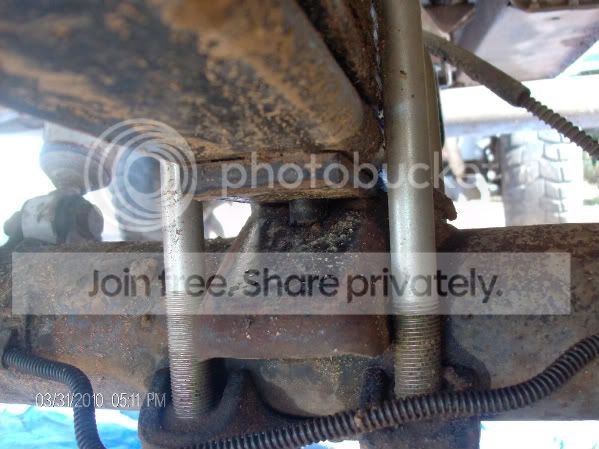

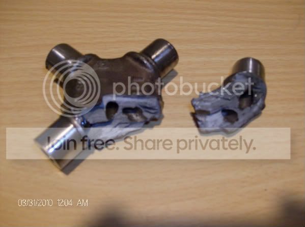

So i was messin around a little bit, and I found out that a hot runnin 350 can spin 35's on the pavement... at a cost. I snapped the U-joint, and rolled my rear axle a little bit. But has anyone else ever crushed their spring perches from doing this? mine are crushed in the front almost completely and apparently, thats not something normal :rolleyes:. My dad used to run a 427 w/ NOS on his 76 blazer - along with 36's, and he said he snapped a ton of u-joints but never crushed his spring perches....
So, has this ever happened to anyone else?
Also, this is on a 71 Jimmy, with the stock 12 bolt in the rear and a 4 speed (i did maybe perhaps dump the clutch :whistle:)

the only thing i hit hard was the skinny pedal, and i can't take pic until tomorrow, but i can take pics of the u-joint...

Rounded spring perches are caused by loose u-bolts. I have fixed lots of them. It requires new perches, center pins and u-bolts. After the loose u-bolts causes the perches to round off, the axle rotates up and breaks the u-joint.
they aren't quite rounded, as much as just plain flat out crushed in the front.
my 14 bolt had crushed perches when i got it.... corrosion usually has some play in it...

so the u-bolt weren't torqued right?
then again, i never checked them, and i bought the rig already lifted so...
also, does anyone think the spring perches are anyhow salvageable? or just get new ones or even make new ones? keep in mind i am on a budget
