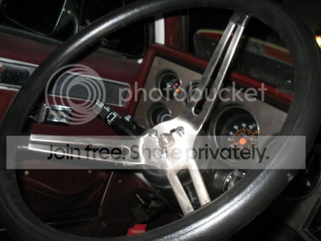

has anyone ever installed a grant classic steering wheel? Heres the wheel
http://www.grantproducts.com/images/prod/969incar.jpg

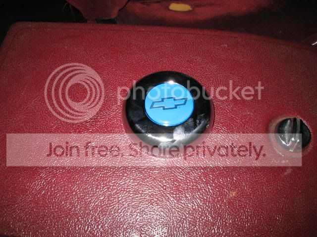

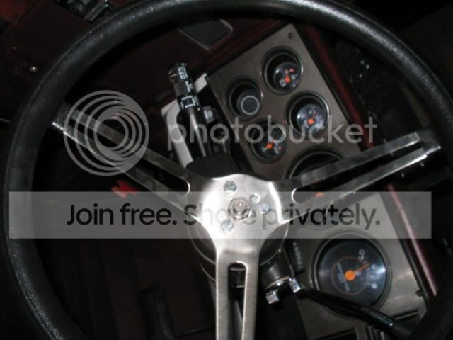

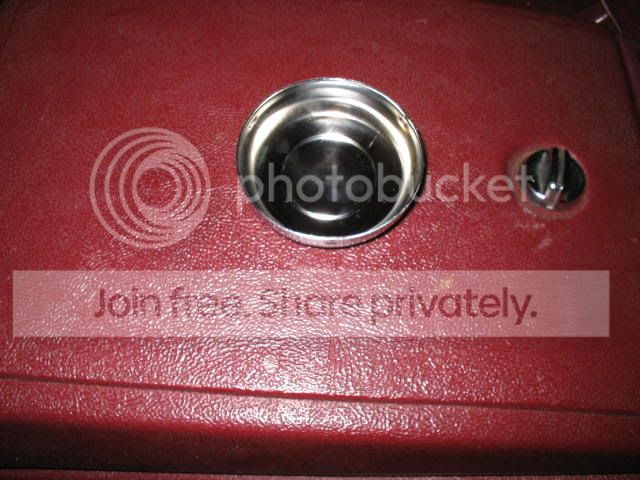

I have the wheel installed fine its that I dont know how the center horn cap mounts...Could it be that since i removed a grant gt series wheel that I dont have the stock hardware that could be necesary?
Im think that after i put on the steering wheel i need to install the stock horn button and the cap will clip onto it???
heres some progress pics
its a 88 k5 btw
I'm gueesing that your correct on assuming that you need the OEM horn peices. Did it not come with instructions when you bought it?
well thanks i guess i am ....darn summit told me that if i had a gt wheel previously then it would work but i guess they were wrong....I think i will still need a stock horn button since i dont have one

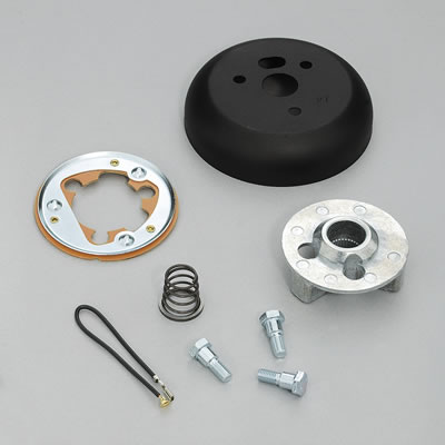

Yep, I've got the same wheel. Summit told me the same thing when I changed from the little ricer wheel the PO installed. You still need the Grant mounting kit for the horn button. I love the wheel but the horn SUCKS; either it falls off or it doesn't work. I'm gonna fab something better.

I picked up a billet horn button and adapter from Summit for one of my Grant wheels. The design is a lot better than that cheap stamped junk in the kit. Been running it for about 4 years without any problems.
