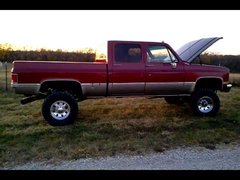

gain 4" by flipping rear 56" springs backwards . :D
Good point, I didnt think about that! I think that would solve what I don't like about the Suburban frame crew cab swaps- the rear tires are always too close to the cab corners for my taste. Even just an extra 4" wheelbase stretch would make a world of difference, IMHO!
Gooooooooofy looking IMHO.
attachment.php
super cool x10
If the wheel was centered under the super short box in the top pic, it'd look great IMO. The short box version below has a nice proportion to it that does look more natural though.
