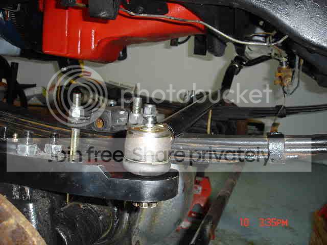

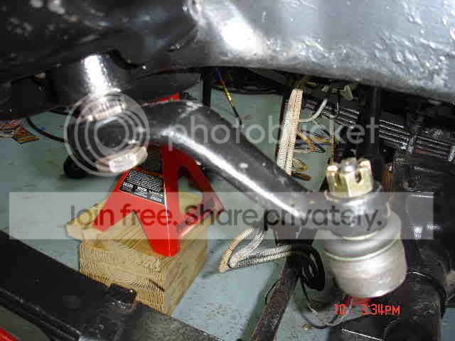

sky manufacturing crossover and high steer installed on a dana 60 front.
passenger side
drivers side
