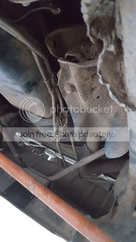

Thank you Chris I could use picture of transmission lines coming off radiator to where the disappear under the front diff. Do not know if they go over or under bar that is welded to frame.

#1 I could use picture of transmission lines coming off radiator to where the disappear under the front diff. Do not know if they go over or under bar that is welded to frame.

#2 is taken care of props to Chris on that. Rest are still up in the air. I know my fuel lines are different from my buddy's as his come off driver side. Ground locations would be nice got 2 so far figured all else fails block to frame! What is killing me right now are those transmission lines in first pic making sure there ran right and then last rat's nest of wiring, it's plugged up but just laying there and want to clean it up nicely.

Can I get a better picture of those transmission lines? Kinda hard to see area I need and does your model have that brace like mine shows?

Got a pic of the trans lines from a 2wd, it's a 4.3 but should be the same.....
They run right alongside the oil pan rail. Held there with those metal clips.
