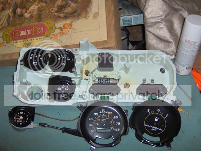

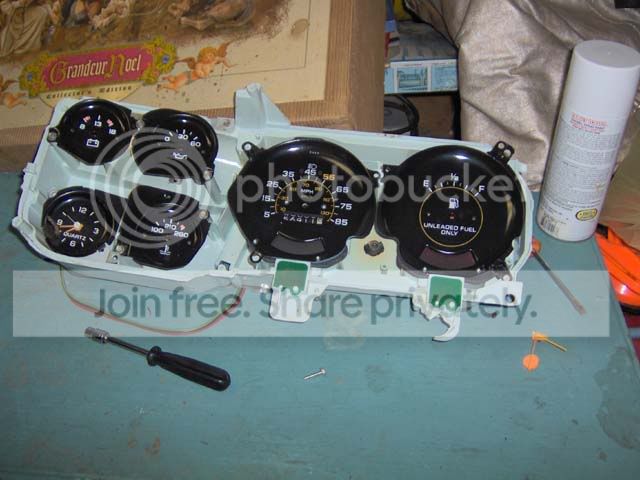

Here's my gauge cluster in "stock" form.

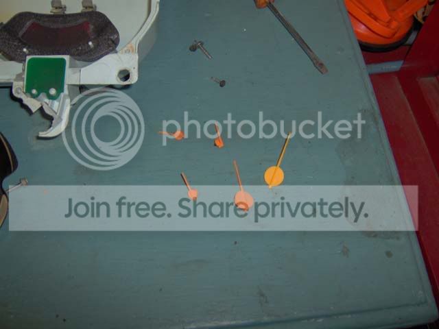

Here it is in disassembley
Dull and discolored needles.....

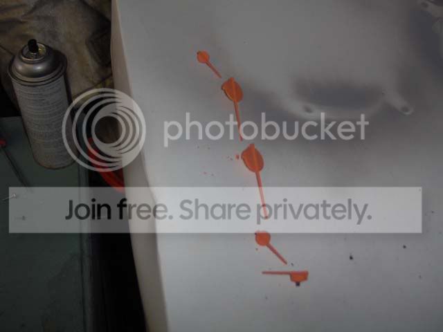

Needles repainted using some "bright orange craft" paint the wife has.....

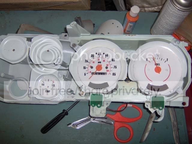

I had to end up and "light" sand all the gauges, cause when I applied the paint it "fish eyed" terribly. I wiped everything clean with thinner, sanded them, and applied light grey primer. After the primer was done, I applied gloss white over that and let it dry and cure overnight. Then I took my overlays and placed them where I wanted them to rest on each cluster and "rubbed" them down. These have adhesive backs and boy do they stick good!

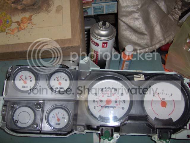

Here prety much is the "finished" product, I had to hunt the gear selector /indicator, my friend had a good one on a old cluster he had. I will do the same thing to it as I did to the gauges, but this gives you a good idea of the outcome. You'll notice that the clear cover that goes over this cluster has the little hole in it for the clock adjuster, the reason for this was when I done this changeover, it had a clock in it, but I didn't plan on ever using it, so I took it out. I figure sometime maybe getting a "vac" gauge or something and installing it.This was real easy for me, this is the very first one I've done. I'm going to do the one in my 4x4 next. Also, I'm planning on using the colored 194 bulbs in this, I'm partial to blue so this will be my color choice. I am going to experiment with different colors to see what "effects" they give on these gauges. I hope everyone like it, let me know what you think. Thanks for your time,
