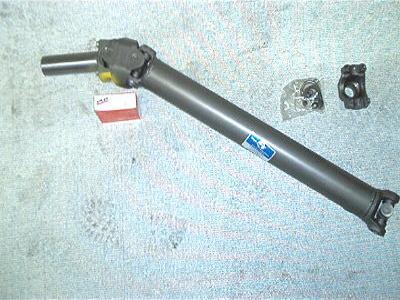

Here is a slip CV shaft.
Right....I get that. My 208 has the stock Slip Yoke. The driveshafts have a slip in them. Like a drive shaft for a truck with a fixed yoke. Sorry. I should have been more clear.
If the driveshaft has a slip in it then the CV end will not work for your t-case because it will be a flanged CV not a slip CV and you cannot have a slip CV AND a slip in the driveshaft at the same time. This is what i explained in my previous reply.
