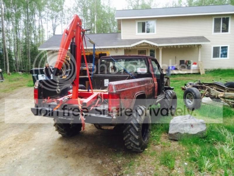

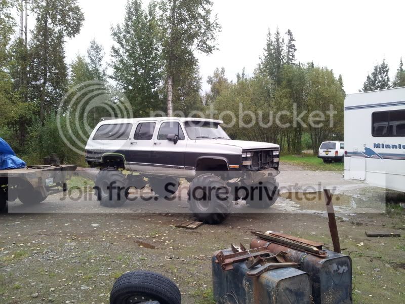

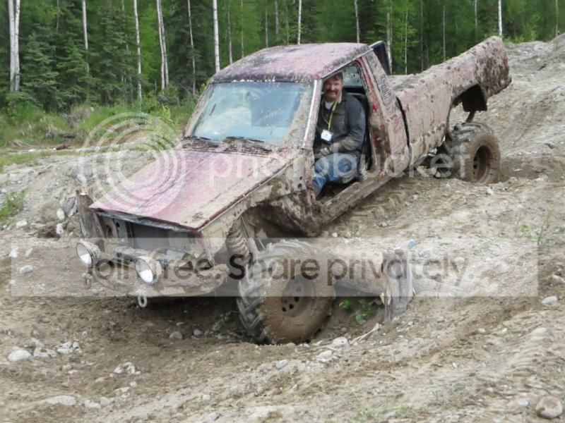

I have run various sizes of ag's from 35" on my little jeep commanche up to 47" on my crew cab and burb what do you want to know?
the Firestone 16.1-16.5-6-ply is about 38-39" tall and is lighter then 39.5 TSL
Those look awesome. What size are the ones on the burb?
Are the ones on the brown truck 16.1 16.5? How much lift are you running on the truck? That setup looks about perfect for me, I think they would fit on my blazer as is. Are they on regular 16 inch rims?

The ones on my Burb are 16.1-18.4 6-ply Apples
Yes they will fit a normal 16" rims
The brown truck has 8" all spring lift normally it runs 38" boggers
As for how they compare to boggers, they don't AG's are different world you don't need big horsepower, and you don't want or need wheel speed the best way to use ag's its to idle through or they will dig down, ease into the gas . and let them work. My little jeep has a 4cyl welded rear diff and open front and it will go through stuff thats hangs up fully locked tons on 38" boggers and 39.5 Iroks.
