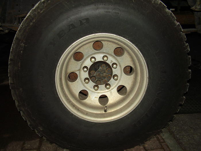

Lots of wheeling with 16.5 here too, no serious rock crawling though. On my 9.75 wide alcoa rims 10psi never caused problems. Actually with more than 12psi my 37 H1 tires won't bulge out at all, front or rear. This is on a K30 with 6.2 Diesel and a 15000 Ramsay winch at front.
Here's a pic of my rim:
And here with about 5 psi:

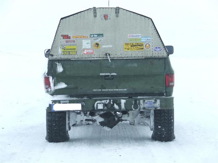

Oh and an inpirational pic too lol:D
