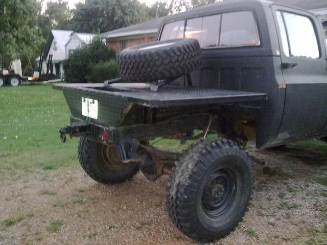

Been wanting to do a crew cab on the suburban frame with a small flatbed, but the non-smog crew cabs are hard to find around here. Which of course got me thinking.. What about a regular cab on the suburban frame and a longer flatbed.. Anyone done this or have pics of this? I tried searching, but to no avail..
Why don't you cut the back of the burb off and graft on the back of a regular cab in its place?
Botta bing botta boom, crew cab on a suburban chassis.
You could even leave a couple extra inches in there for rear passenger comfort.
Put 64's in back while maintaining the factory front hanger position for the rear springs and shift that axle half a foot back and you'll have more tire clearance.
Buddy of mine did that on his sub.
Worked out not bad after be built proper rear cab mounts.
I know someone in NH that put a decent 2wd pickup cab on more than one 3/4 ton 4x4 Suburban he bought cheap, due to a lot of body rot...he just put the rear cab mounts off the donor pickup on the Suburban frame in the right spot,and modified the floor tunnel so a body lift wasn't required to clear the transfer case,and made a flatbed for them..

There's only 2" of wheelbase difference between the burb and a longbed pickup.
So I don't see the point of a regular cab on a burb frame.
Looking at the sheet metal, a Suburban behind the front seat is exactly the same length as a regular 8' bed. The axle is pushed forward 2 or 3 inches, but the length is the same. So a truck cab on a Suburban frame will give you...a normal 8' bed from a LWB truck.
If you're looking for 4 doors, chopping up a Suburban isn't a bad idea. Or you could leave the bed enclosed and just run a normal Suburban.
Response to Blazinzuk ...
Its a cheap way to get a nice pickup ,that was the reason the guy I know did it..bought a 2wd pickup with a blown motor cheap,and a rotted out 4x4 Suburban and married the two together...he sold one at high profit and used the other for himself to tow and haul firewood..
The only time you'll notice the 2" shorter wheelbase is the turning radius is slightly better than a long bed pickup..
