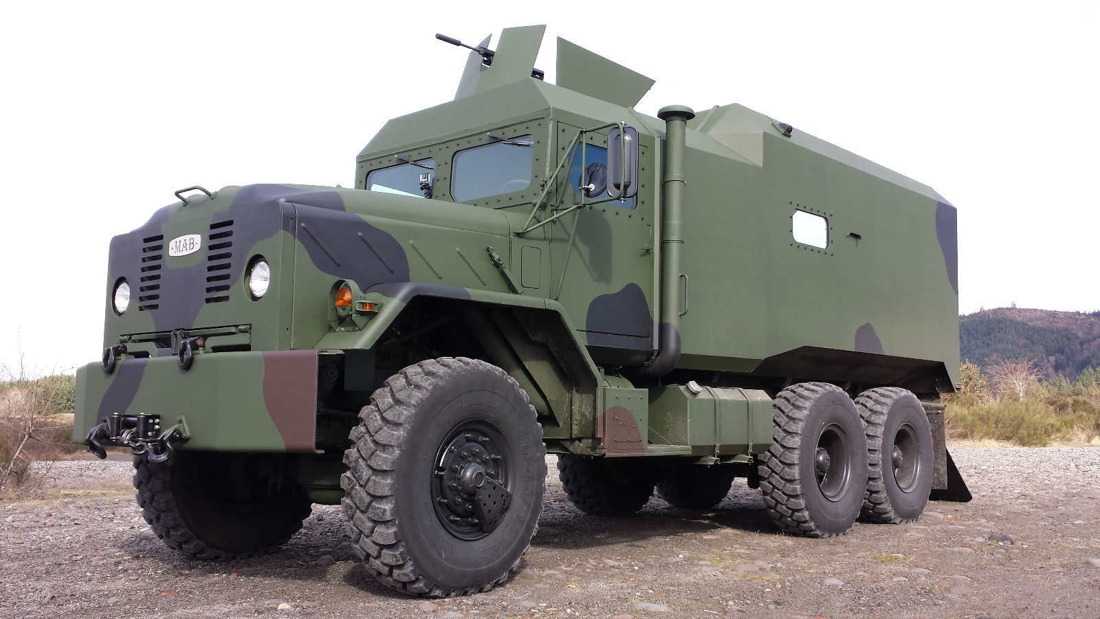

1990 BMY M923A2 6X6 MRAP Style Military Doomsday Truck
http://www.ebay.com/itm/1990-BMY-M9...em=161255002957&pt=Military_Vehicles#viTabs_0
Whole lotta fail there.
Looks like the original door hinges. Enjoy opening those heavy doors when those start to fail.
What's with the roof raising behind the turret ring? Better hope you never have anyone closing on you from behind.
That armor plate...is it me or is the engine bay above the tires and inside the wheel well completely open?
All those bolts and nuts facing you inside the cab...aside from the ergonomic issues if an explosive was to hit that plate and send those flying inside the vehicle...
Flat cab bottom...doubt they armored that.
It's a big, expensive, overdone and under thought MRAP imitation.
It's cool looking at first blush, but it's nothing close to an MRAP. Those letters shouldn't even be used in the same listing as that abortion.
