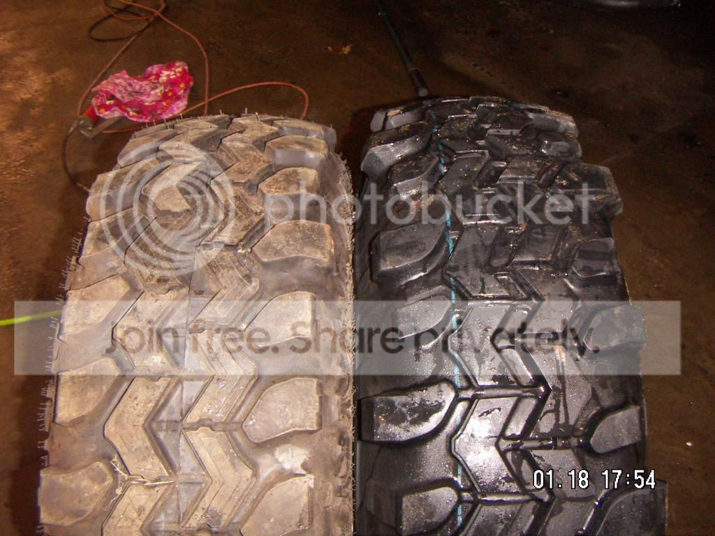

Here's how the 37x12.5 SSR compares to the 38x12.5 TSL. You can see there is a little less void between the outer lugs and the outer lugs aren't quite as tall. The overall carcass is wider.
3 of these SSRs measure out pretty round. The 4th seems to have a spot 1/2" low. The 8-bolt Hummer rims are kind of a wild card and they leave you room for error. I might try messing with it to center better. They are smoother on the road than the bias TSLs were, but they are not everything I hoped for.
