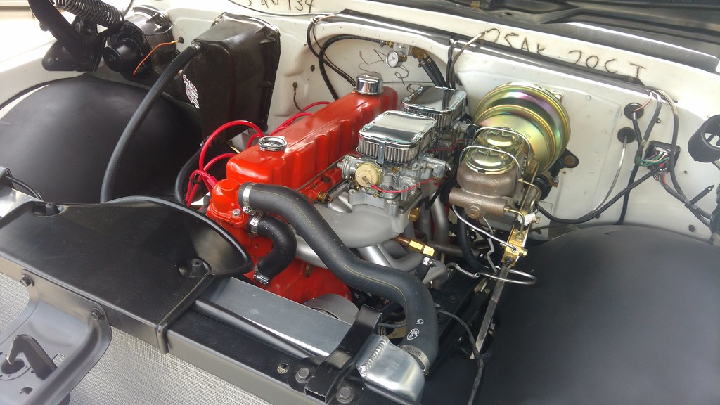

Lets keep a couple of things in mind here. Straight 6's make torque. Gobs of it down low. They aren't high winding builders of horsepower. However if we look back in time to before the gas crunch era where GM made shitty attempts at using straight 6's for fuel economy (like the 250's you noted). Back before that time, you usually found a 6 teamed up with a manual tranny and deep axle gearing. No they didn't do 70 mph, they weren't built for that. It wasn't out of the ordinary to have a 6 with 4.10 or 4.56 gearing. That's how they made use of the 6's prodigious low end grunt.
Now lets bring it back to the current and use a combo of old and new tech to put together a decent running combo that isn't a danger to itself and keeps up with modern speeds. A 292 tied to a NV3500 with 4.10's and 31" tall tires (assuming a 2wd burb). The 4.10's are going to make use of the 292's torque but the OD gear allows it to get rolling at a normal highway speed without winding out the big 6 to an unreasonable RPM. Modernize the 292 with a decent Clifford Cam, electronic ignition and a computer controlled EFI system and I'd bet that the combination would get mid-teens or better on the highway and still have good power to keep up with traffic.

I helped a friend's son buy a c10 with a straight 6 in it. Dead stock. He put a header on it nice 2 barrel carb manifold. All the external tricks. That thing ran awesome. Got 17 to 19 mpg on the highway. It was also the only truck my dead bone stock 6.2 could stay with easily. In addition he rarely went more than 65 mileage dropped rapidly after 65. At 75 he was only getting 14.
