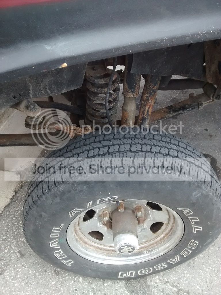

Don't want to torch off the spring bolts and U-bolts to swap the leafs out? Use front helper springs:
Just cut the coils down until you get the lift you want. :doah:
Even I am not that brave,though I admit I did give some thought to that idea,I even got a small coil spring from a friends shop's junk pile,and cut it up,but decided if it ever moved, and punctured the tire,etc,I wouldn't have to worry about a rough ride any more..just if I'd live to talk about what a stupid idea it was..:doah:..
