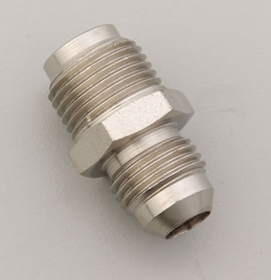

isn't this what you need, inverted flare to AN?
edit*** oh, i see the prob, thats 5/8's, nothing goes down to 5/16's... they don't even have 5/16's tube to 6 an, only 3/8's tube to 6 an... hmmm, further investigation is needed... i want to know too... i hate the idea of restricting the flow down that much, but without custom rad work to run larger fittings, hmmm... maybe a call to my rad guy and see what he thinks about putting larger fittings in before i install... i'll get back to ya on what i find...

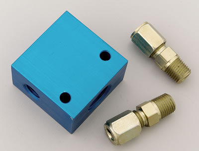

A bung for what?
If it's for a temp sender I used this:
Taps into the cooler line out of the tranny to the cooler. That way I know the hottest temp the tranny is running.
thats fine for the hard line, i already have one of those, but i am useing -6an line now.
thus my problem.
why is it a prob? that thing has npt right? just put 2 npt to 6 an fittings in it.
mine is a little different, it came as a "T" and it only has the compression fittings, it came with the cooler
Surpip, I going to repost what I said from your last thread.
JDNobodi said:
I'm going by tubing size. but to buy an adapter, you have go by fitting size. Messure your fitting and pick your adapter if they make one.
What this means is the fitting have to bigger than the tube and there could be different size fitting for a given size tube.
I just measured a fitting that goes to the radiator cooler and it was 1/2-20. The tube was still 5/16.
So, this is the fitting you are looking for.
Sorry for the confusion.:crazy:
