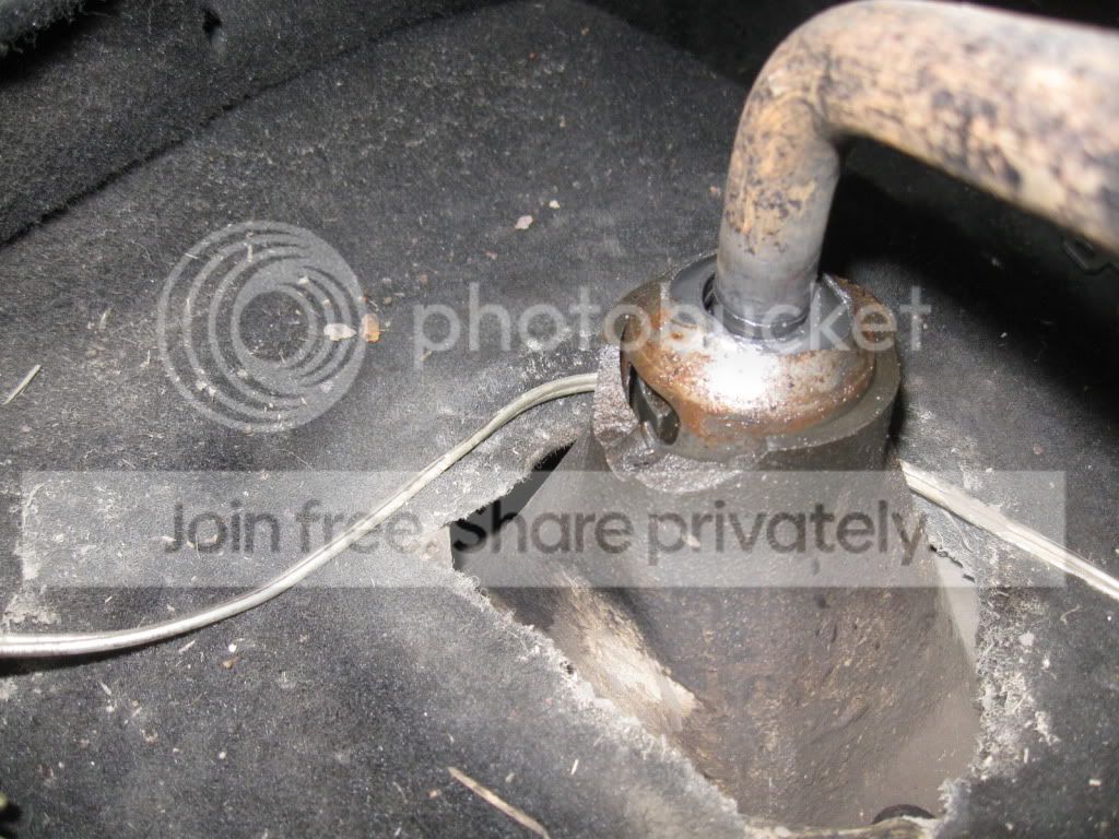

So I've posted before about my plans to swap my 700r4 for a SM465. But I'm wondering how much of a PITA it may be because I'm pulling parts from a 76 Jimmy for my 85.
One, does this raise any alarms? I don't think that's supposed to be chipped off lookin'

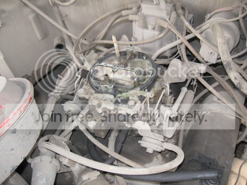

On the other note, should I just try to get a rebuild kit for my valve body on my 700r4. I want to use the carb from this truck, but I don't know if I can. Number is 7045583. I'm looking at the TV made easy kits. Also the I guess heat riser style choke bolts to where my EGR would be correct? It's a performer rpm intake manifold, with the EGR block off plate bolted on.

First, the shift tower on that trans is broke. The chunk that's missing has a dowl pin (just like the opposite side) to hold the shifter in place. I imagine with that pin missing at best the lever will feel sloppy but maybe move around enough to bind up.

Ya I noticed the otherside was nice and looked around to the other side and saw the chunk missing. It does like to get 'stuck' and then you gotta F with it to put it back in gear. I know it wouldn't have any of the brackets, what I was worried about was the mounting hole locations, I can eyeball where the rod goes through the floor since it wouldn't be perforated, or whatever, but all the dash stuff, that's too many locations to measure and screw up.
Anyone have thoughts on using that carb with a 700r4? I hate the edelcrap I have now. Never had anything but an electric choke, so I'd have to get info on that style choke it has.

I'm not, I am however weary about the SM465 itself. The manual clutch system is a last resort, I would just 'like' a hydro clutch, but it would all depend if parts are easy to find/cheap. Few junk yards around here. I'm not keen on putting in a broken transmission, broken innerds are one thing, broken cast body on the other hand... if I had that missing chunk I wouldn't mind attempting to weld it, even if the body is cast.
Oh the carb... I just dislike edelbrocks. I enjoy the drivability and economy q-jets offer, I personally can't seem to get that with an edelbrock.

Any ideas for repairing that missing chunk? Still leaning on ditching the manual clutch system and scouting out hydro set ups.
