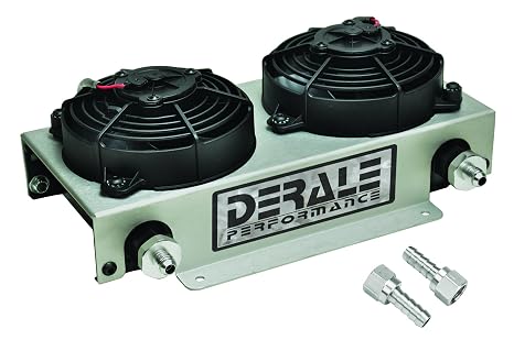

Going to pick up a new cooler and wanted to get some opinions on what you guys are using. Currently it runs a t-350 but I want to get a cooler to support a 4L80E. So I am going big.
Do I get a remote mount one with a fan even if I put it up front?
The ones with the fans aren't not much more costly and it seems like a good idea for low speed, and idle conditions.
I have had good luck with derale stuff before and think it it would be fine here as well.
Cost isn't a huge concern as the most expensive ones I have seen are around $250, I would spend that for a nice unit.
Thoughts?

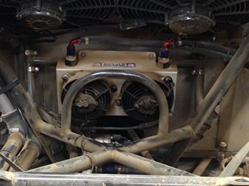

I toasted my TH400 on a trail run in western Colorado. I had a tube and fin cooler with NO fan. It was a hard trail with slow hard crawling and I feel like it was due to the trans cooler getting no air flow. Since then I've run the largest B&M stack plate cooler I could get along with a 12" fan that is activated with a thermal switch. No cooler in the radiator tank. The 700r4 I have now has held up a lot longer than the TH400. I feel that's a testament to the cooler setup not the transmission itself.
I run all of mine through the radiator first then through the largest stacked plate design cooler I can fit. Contrary to popular belief the radiator does pull quite a bit of heat out of the fluid and keeps doing that even at low speeds when the air flow across an auxiliary cooler isn't so great. I don't run electric fans as this is just another potential failure point and complication. If you cant keep it cool with a well designed radiator cooler and big stacked plate in series then you have a problem there.
My brother has the stacked plate Derale cooler with a fan (I think the bigger one you posted) on his Dodge M37. 650hp BBC & th400. No transmission issues

think I found my solution. Small, dustproof and waterproof with -6 AN fittings.
http://derale.com/products/fluid-co...hyper-cool-dual-cool-remote-cooler-6an-detail
I run the biggest tube/fin cooler that I could find. It was a bit of a pain to install behind the grill, but temp almost never over 200° or so. And that's only sitting in traffic on hot days etc. Dexron 6 synthetic fluid. Monster Transmission built, 500hp rated TH400 and Hughes XTM towing TQ converter. Cast aluminum pan with temp sending unit. This setup is set and forget. Almost never see the temp gauge over 200°. Maybe one day I'll mount a fan on it, but I don't feel it's needed.
Trans cooler bottom left, engine oil cooler bottom right, AC condenser and radiator top. I have an 18" round extruded aluminum power steering cooler mounted to the back of the winch bumper too.
