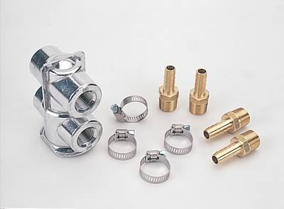

That summit thermostat looks pretty cool. I have a 2.5 mile commute and sometimes wonder if the tranny warms up all winter.
These Derale Cooling Products fluid control thermostats will reduce warm-up time, especially in cold weather, by allowing transmission fluid to bypass its cooler until the fluid temperature reaches 180 degrees Fahrenheit. Each thermostat includes 3/8 in. hose barb fittings and hose clamps.
2.5 miles = not a chance unless you warm the truck up in the driveway for a bit.
my old crewcab 96 would hit 140* in around 3-4 miles after 10 min warm up with remote start.
