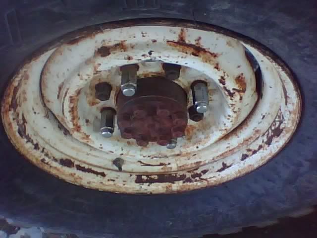

Then start doing some searching on here for the difference between a full floater and a semi floater. The factory 10 bolt is a semi floater. The same as a 14bsf (14 bolt semi floater). Then there is a 14bff (14 bolt full floater). The full floater has a hub on the end of the axle with bearings riding on a spindle so there is no weight on the actual axle shaft. I'll look for a picture.
Martin
Here is a picture of the hub sticking through the wheel on a full floater. A semi floater would be flat with the wheel. Also, a semi floater doesn't have the bolts on the end. Those are retaining the axle shaft.
