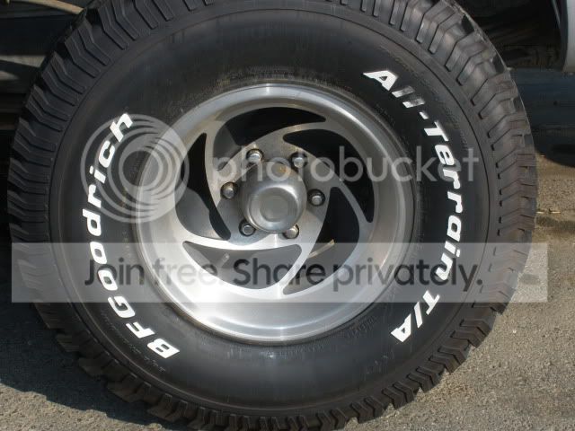

I'll take a pic of my rear axle tonight. I have the Light Duty 14 bolt sf with the 6 lug rims. They are definetly 6"on 5.5" so as said above, rims should work.

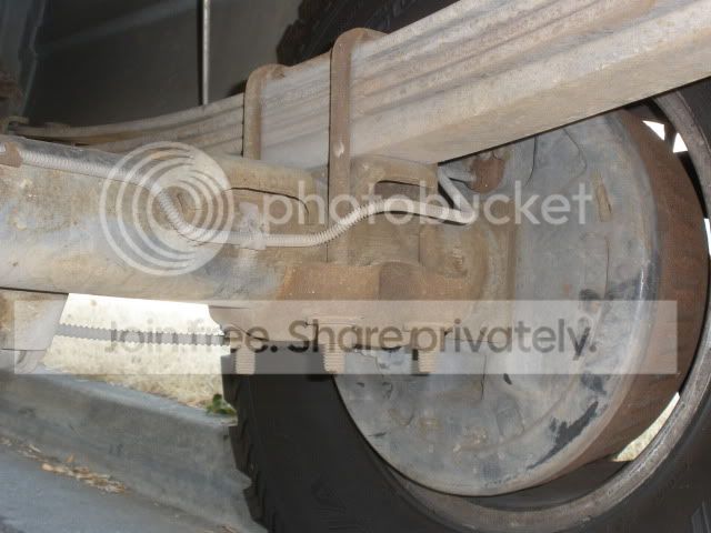

I need to look again to be sure but I believe the U-bolts are mounted reverse/upside down. Upside down to me is the opposite of this "U". Nuts on the u-bolts are closer to the ground.

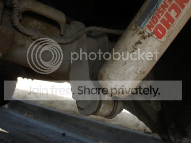

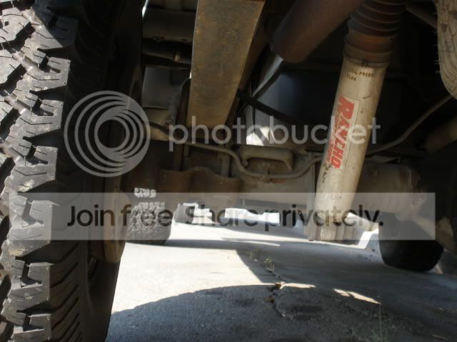

Okay, I just snapped a couple pics. These light duty 3/4 ton axles are way different than I thought (hey I'm still learning too). Spring perch is 48" center to center compared to my 3/4 ton burb which is 43" center to center. The shock mounts are different also. I think you're better off doing what was said earlier and find an 8 lug ff or sf. Here's some pics anyways for reference.

6" on 5.5"
Reversed u-bolts
Shock mounts
