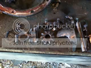

the limited slip blew the carrier apart and the center pine came out and just broke everything spiders ring gear pinion gear lol everything.

here is a crappy cell pic but you can kinda see what happened
