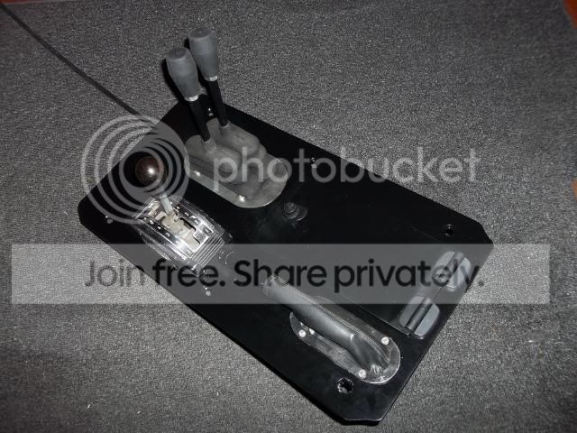

I have had both the art carr and B&M pro stick. Both are good quality, just different style shifter. I went with the pro sticks lately so I could panic reverse from 1st gear with a standard valve body. Going with a reverse VB and art carr again for the buggy so thinking of selling off the modded pro stick with a new cable still in package. Its modified so you can slam neutral & trigger slam reverse.
Modified like this: http://www.pirate4x4.com/tech/billavista/shifter/

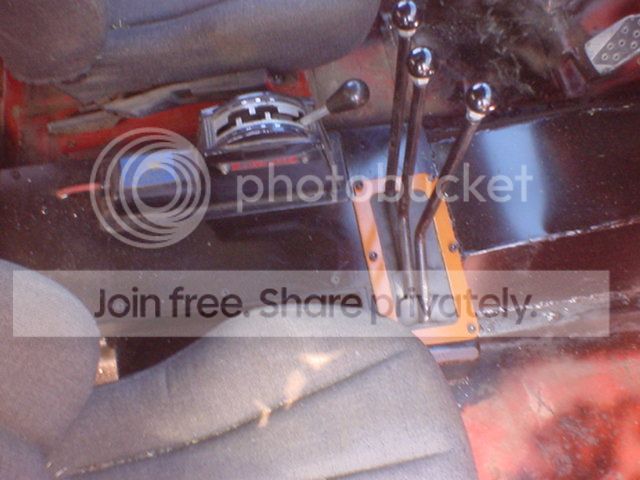

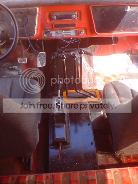

in sonoma, picture was during initial build. I ended up raising 3" more and moving next to seat and bent brake handles to clear it.

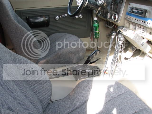

Art Carr in the k5:

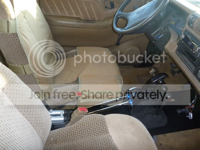

then went to the pro stick:

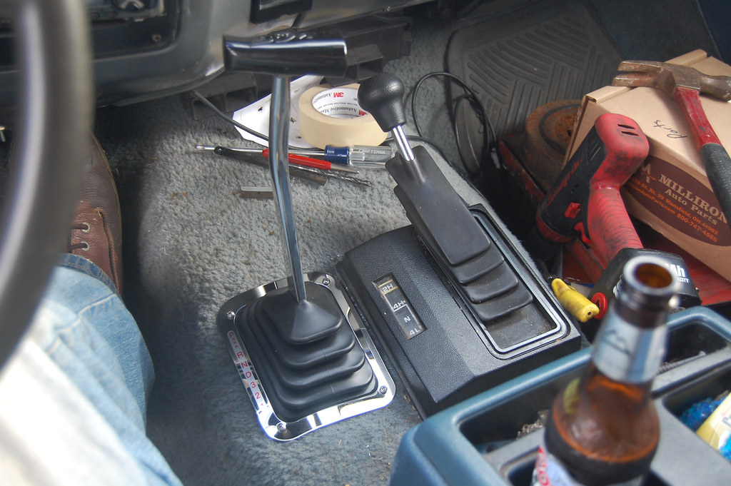

and my lokar in truck up in 4 speed hole with boot on it. and my ord twin stick setup for the 205.
